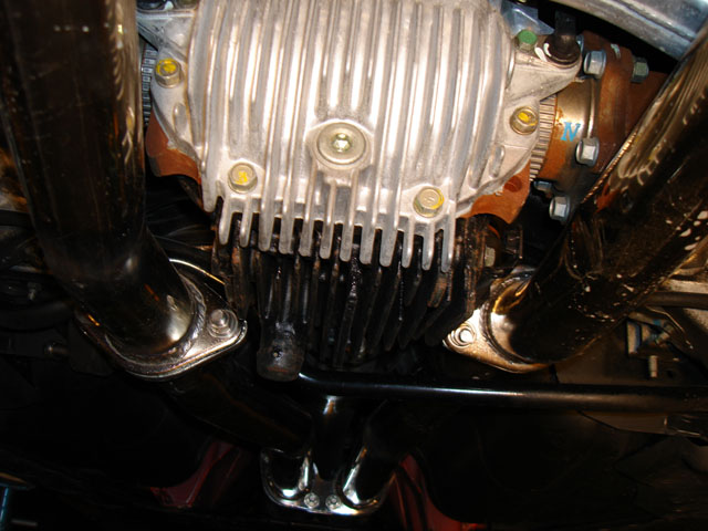

I was just wondering if its only the European Z's that have cooling wents on the rear differential?
Ive seen some pics of US cars diffs but they have all been smooth without the cooling "ducts" that my car has (see attached pic).
At the moment im having some issues with them as my HKS exhaust dosent clear them propperly, so i need to come up with some way to isolate them with heat resistant rubber or to create enough clearance some smart way...

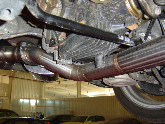

It looks like the interference he's talking about is with some cooling fins on the diff itself, not the cover.
Here is a pic of a US car in that area:
No fins on the cover or the diff housing itself, like he has. Weird!
-E
well, thats not a factory exhaust... I think thats a DC SPorts exhaust?
but, the fins do not get in the way on any US Z's or G35's with factory exhaust, or ones that follow path of factory exhaust or dual exhausts like Injen, HKS, GReddy....

Even GCC specs but I had to cut it and grind it when I changed the exhaust system.
Attached Thumbnails Does any US Z model have cooling ducts on the diff? *PIC*-dsc00521.jpg   Does any US Z model have cooling ducts on the diff? *PIC*-dsc00519.jpg
Yeah thats what i was looking into doing as well... on the HKS there is a connection between 2 bits of the exhaust just at the diff that takes alot of extra space. The exhaust didnt fit at all initially, my shop had to bend the piping to get it around the diff at all.
Ill try with some heat resistant rubber and a metal plate in between to prevent the exhaust from grinding down the rubber, i already tried this but that came loose after just a few miles due to the thermo related expansion of the exhaust + all the vibrations, so now im trying to find something heat resistant to fix the bushing with...

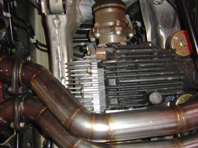

Yeah I know I also have the HKS exhaust, but what I did is I cut the fins to clear the connections. Check out the pic.
Az
Attached Thumbnails Does any US Z model have cooling ducts on the diff? *PIC*-hks02.jpg
Az
Ahhh ok, hehe then you know exactly what im talking about
Do you have a closeup pic of the diff with the cut fins?
/Roger
I have the same pic and another one but in Hi-res which is about 1.3MB each. PM me your e-mail and I will e-mail it to you.

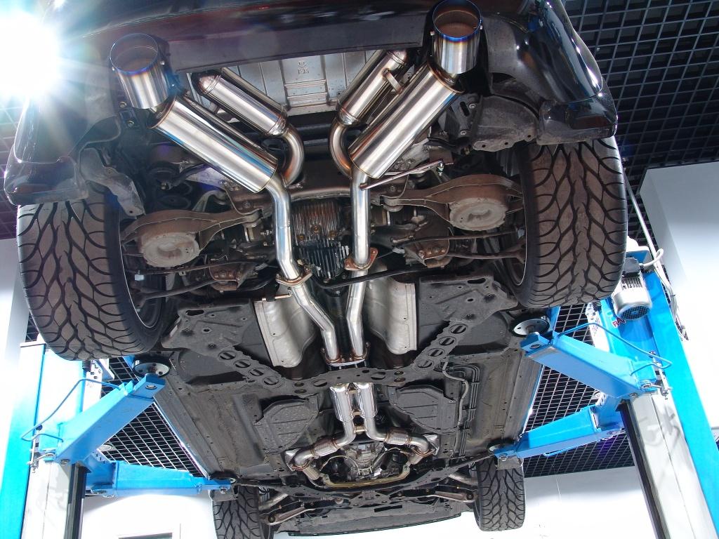

Here is a pic of the car on a lift (posted earlier in this thread)
https://my350z.com/forum/attachment....8&d=1150874896
There are plenty of locations to lift the rear, never lifted a car on the diff...
/Roger
