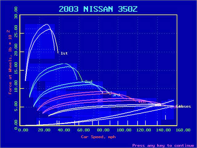

k well here's a tq vs speed chart
tq or power vs rpm will not change though which is what your typical dyno chart is comparing

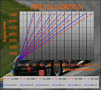

2nd chart is rpm vs speed
Attached Thumbnails Final Drive and Power gains-35vs39_tq_vs_speed.jpg   Final Drive and Power gains-gearchart300x.jpg
