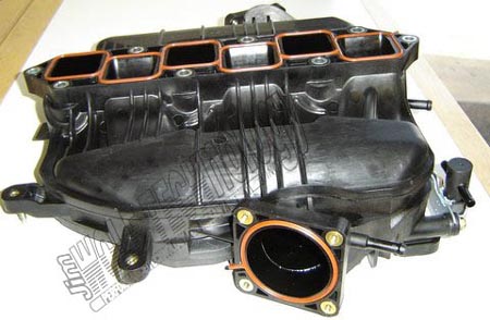

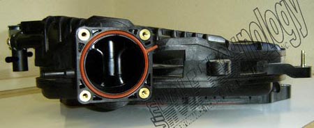

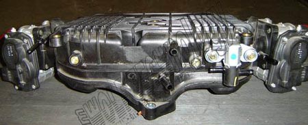

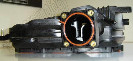

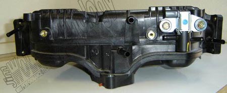

What did you have in mind
By the looks of it, it does not seem like the plenum is meant to come apart. Guess we will know once we get our hands on it.
Plus, i dont see a flat spacer going into this thing either. Look at all the curves in it.

No. Probably no spacers or milling here. I'm thinking it will require a totally new injection molded assembly.
It'll take hefty $$$ to make the tooling though. That's the biggest deterrent. I'll have to experement with prototypes to see if the gains are worth the investment.

I don't think there's any chance this intake is going to fit the current VQ at all. There are too many changes to this HR motor. The block has a taller deck and the cylinder heads are all new. This means the likelyhood of this manifold fitting our heads is minimal. Also, this manifold looks taller than ours so it would probably hit the hood.

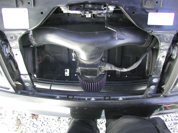

Your right the 300zx did have two throttle bodies, but only one MAF. This new engine design has 2 MAF. The 300zx was setup like a Y-pipe that merged into 1 MAF.
I guess we will see what the turbo kit designers come up with.
