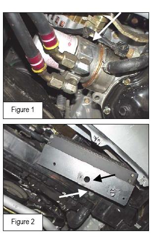

I did see the pics, before buy any kit, of the Stillen installation instrucction, and if you see the pics, won´t fit with the aps oil pan , and the oil radiator won´t fit in this position, or even in your position , because the air filters are in there.............

did you were mine was installed? do you see it being installed in the same position where the instructions say?, ovbiously is you are an "automaton" and you can't think outside of what the intructions say it will not fit.
doesn't take a lot of custom work to make it happen

I agree with Quiksilver. If you don't have a brain than nothing will fit unless it is perfectly built OEM. The Stillen would fit and work if you had wanted it to. Saying it doesn't fit tells people that it will not work at all. I have the Stillen and didn't install it where the manual said cause I have a Vortech and the FMIC is in the way. I made it work.
