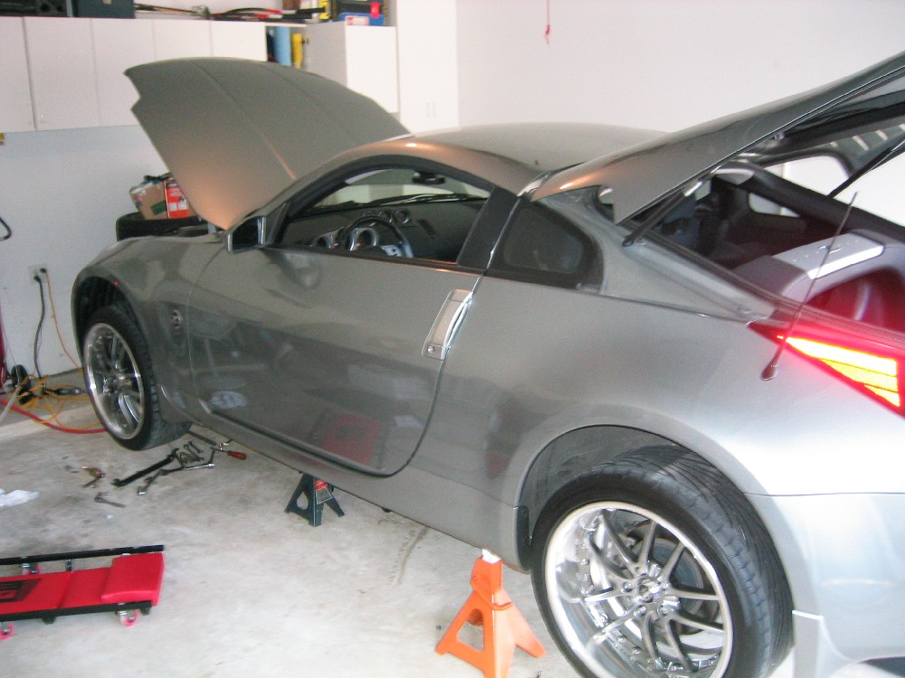

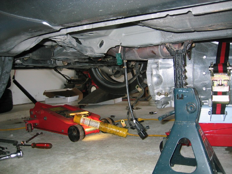

I found this trusty little gem on sale for like 55 dollars at harbor freight and it worked great. You’d still need to raise the car higher if you actually needed to remove the tranny but for this job its perfect.
http://www.harborfreight.com/cpi/cta...emnumber=39178
This clutch flywheel combo feels good and at idle actually sounds quieter than the stock setup, my old throw-out bearing was unusually loud compared to this. I’ve finally heard the cement-mixer sound everyone talks about but I can live with it.

Not sure exactly how long as I did over the past three days. I kept having to stop and work on other work related projects and get little odd ball tools to finish up. I'd guess about 5-6 hours, I took my time.

yeah for anyone thinking of doing this make sure you have all you need beforehand. It sucks when your moving along and then realize Oh snap! I need a bigger torx bit for the flywheel!!! Arg!! BTW you'll need a T55 bit, most sets as mine go up T-50.

I had that very same "trusty little gem" and the fu(kin scissor broke while lowering the transmission on my F-150. Crushed my arm and pinned me to the garage floor. There's a reason it only cost $55.00. There is a hydraulic model available for about $175.00 which is much safer. I understand there is a difference in weight between the Ford tranny and the Z tranny, but why take the chance.
