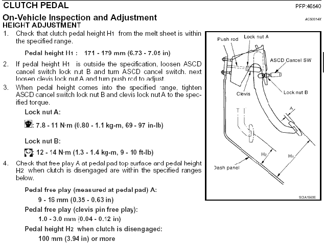

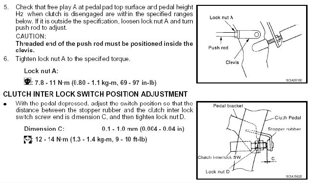

This looks really nice! I would also suggest, to anyone doing this, to modify their clutch pedal throw. This is the 1st thing I did to my car when I got it. I probably cut the throw in 1/2. With the Q-Shifter, you're going to be much quicker with your hands than your feet in pressing the clutch pedal.
Mark

Mark, how did you shorten the clutch throw? I do not like the long throw and would like to change it.

Originally posted by patdsaunders
I want to try this also. Will contact.
Old Apr 1, 2003 | 10:27 PM
msink's Avatar
msink
Posts: 153
From: Cary, NC
next
