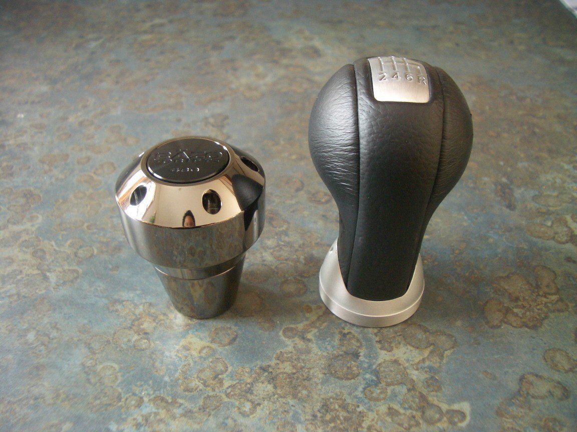

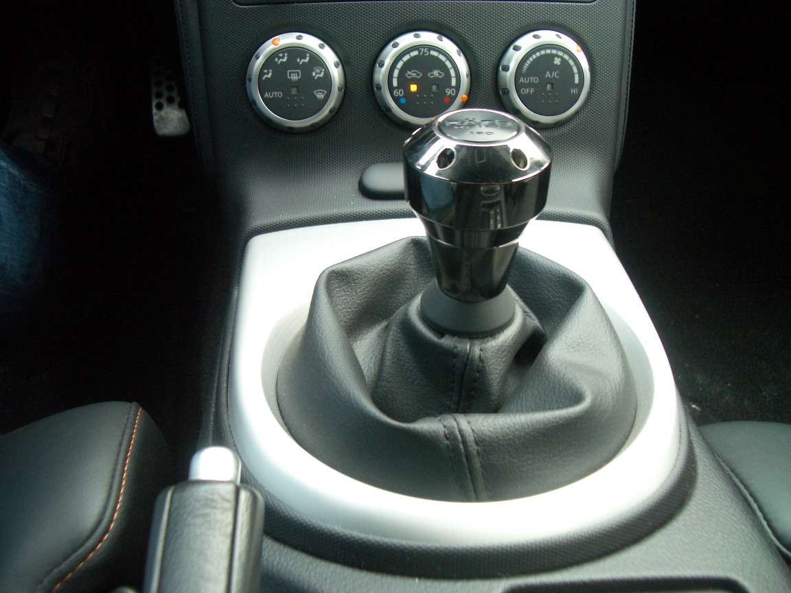

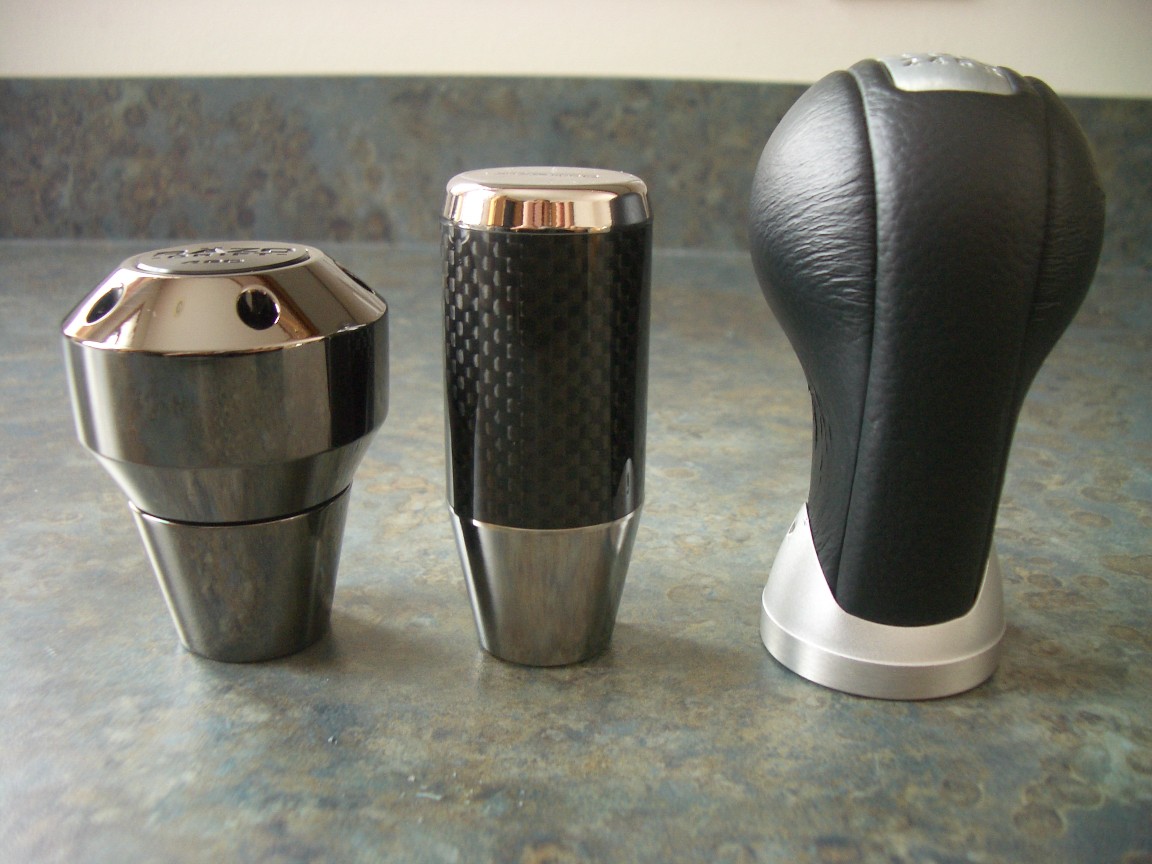

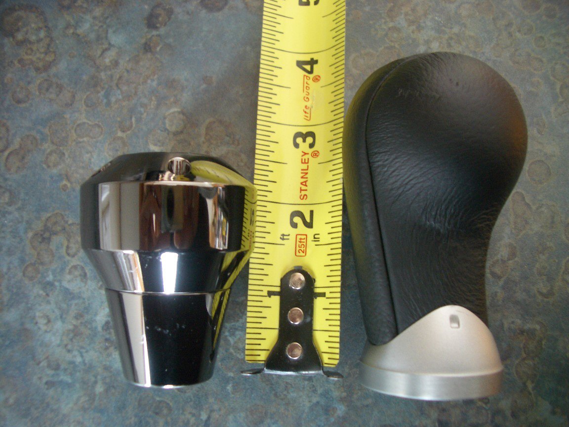

Default Consider a shorter ****
You'll get both sides of the argument from people who've had good and bad experiences. At the very least, there's the expense of the rod plus installation. Before you you undertake that (and it's not a difficult job), have you considered a shorter profile shift ****?
I initially switched from the stock **** to the Nismo CF ****. It was a little shorter but a lot skinner, and just never felt right in my hand. Way too thin, in my opinion.
I just replaced the Nismo **** with a RAZO RA117 ****. It's about the heaviest **** on the market at 480g, which is 1.1 lbs. The stock **** is 215g or just under half a pound, and the Nismo **** is lighter still. The RAZO **** has 3 different height adjustments and I used the lowest height setting for the shortest throw. I kept the finishing washer from the Nismo **** because it looked good, but removing it would shorten the throw even more. To help make up for the shorter throw and reduced leverage is the mass of the ****, which lends quite a bit of inertia and smoothness. It's also quite a bit shorter than the stock ****.
If you're considering the short throw, you may want to try a shorter **** first. It makes a significant difference.
Attached Thumbnails short throw in 350z?-knob4.jpg   short throw in 350z?-knob3.jpg   short throw in 350z?-knob2.jpg   short throw in 350z?-knob1.jpg
