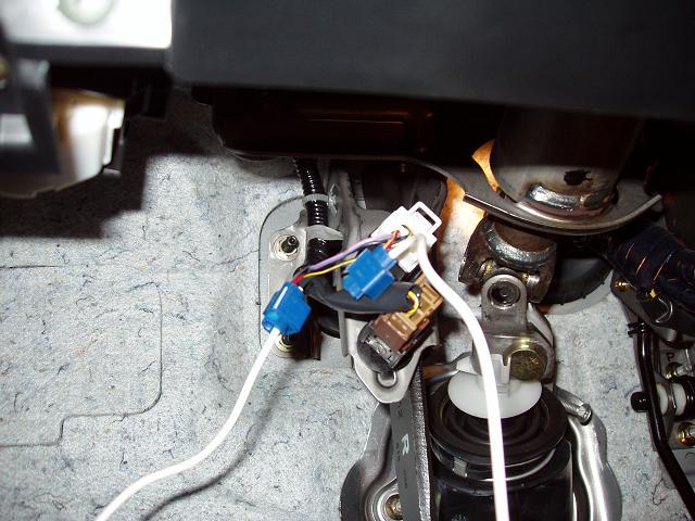

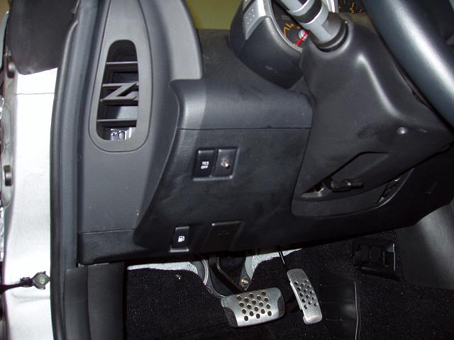

i used skidazzle's advice and heres what i came up with. i tapped the red/yellow brake signal wire before it connects to the brake pedal (there are two connectors; brown & white). the white connector contains the red/yellow wire so as i said i tapped it and connected this to a push button switch. then i ran the switch to the blank switch next to the tcs button, and installed it there. and voila, instant burnouts!!!
Attached Thumbnails In desperate need of technical help (wire to disconnect for burnouts in an Auto-p1010011a.jpg

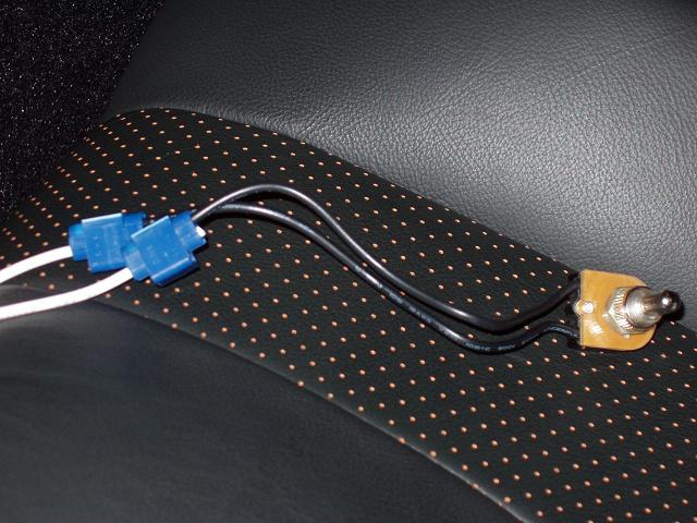

here's a second pic. this is the switch i used (picked it up at lowes actually).
Attached Thumbnails In desperate need of technical help (wire to disconnect for burnouts in an Auto-p1010016a.jpg

From: Knoxville, Tn.
and a final pic of the switch installed. sorry its a little out of focus, i took the pics right after the install and was in a hurry to try it out.
Attached Thumbnails In desperate need of technical help (wire to disconnect for burnouts in an Auto-p1010021a.jpg

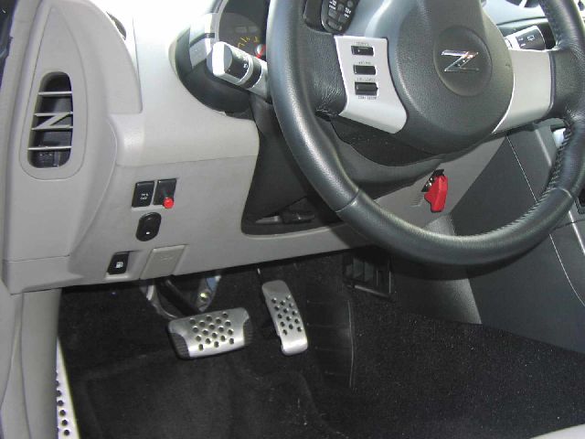

I am taking your pics to my audio installer and using my Nitrous Switch for on off burnouts. How cool will that be?
I can hear it now. "Hey what does that red switch do?"
This one? Hang on tight I will show you!"
He-he

Attached Thumbnails In desperate need of technical help (wire to disconnect for burnouts in an Auto-3switches640.jpg
