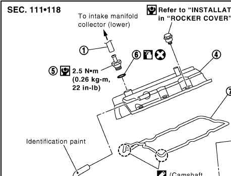

BTW - the PCV valve is located on the valve cover near the front of the passenger side.
