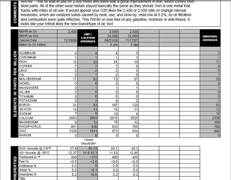

After using Mobile 0W40 for about a year I finally switched to Rotella T 5W40. My Iron is much better and I think I'm going to stick with this one. I only have 2400miles on the oil because I was doing some work (tranny, Diff fluid change) on my car so I decided to change the oil as well. The 2400 miles was definitely wasnt babied, it has over 25 1/4 mile drag (14 at the track and over 10 with my Gtech). It also have countless of WOT pull all the way to redline when I was tuning and preparing my car for the Track.
Essentially identical wear results, but with less Fe wear and at a lower price. Gotta love The T-Syn, it's been a stellar performer in every VQ that's used it. Thanks for contributing, athenG!

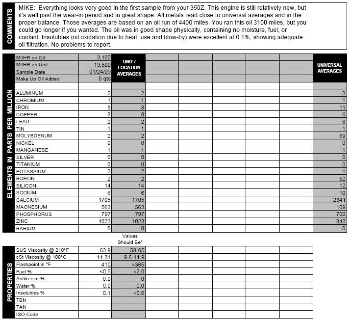

Just thought I'd post up an analysis
06 revup, Castrol 0w30 German, Mobil1 filter ran for about 3100 miles. I only changed it because it was over a year...
Old Feb 21, 2009 | 10:28 AM
  #755
Resolute's Avatar
Resolute
Posts: 2,097
From: @7000 ft
No issues with the oil or your engine according to that UOA. The average copper wear result with GC is a little better than this for approx. 3k miles, but I imagine the car was sitting for some time in-between driving, or had a lot of really short trips, which doesn't make things easy on the oil. Moisture build-up and additive fall-out occurs with long periods of inactivity, and makes cold starts even harder in terms of wear.
