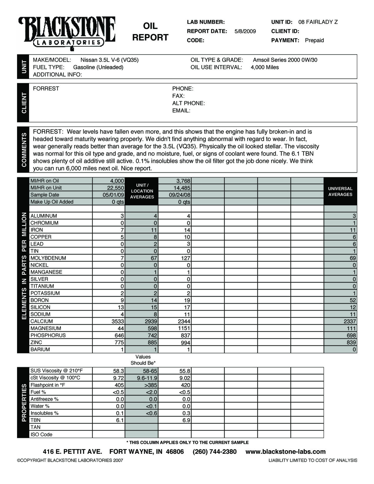

Default Amsoil Signature Series 0W-30 + Amsoil Ea012 Oil Filter
Any comments are welcomed!
There must be something to pick on? Calcium seemed a little higher?
What do you think Resolute?
Note: Last report, I was using Royal Purple 5W-30 (9/24/08). After that, I switched to Amsoil Signature Series 0W-30. I had an oil change after that, and did not send in for analysis - as I wanted to have the Royal Purple clear out completely. This report, therefore, is untainted. (I hope...)

There's nothing wrong with this report. It's now farther down the break-in path, and all wear metals look great. The oil is on the thin side for a 30 weight but should be shear stable and not get any worse.
Calcium is from the oil, not a byproduct of wear. Your TBN is still very good, meaning you can extend to at least 5K miles without a problem. No worries, looks like your VQ likes this oil.
