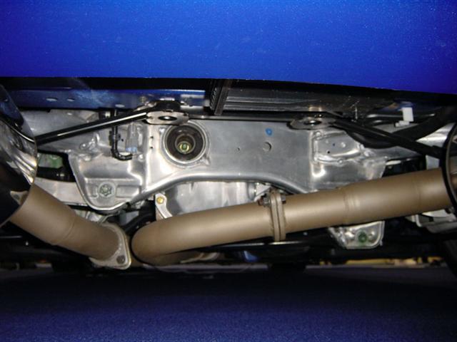

That's, a sweet looking exhaust set up.
What is that an H-Pipe true dual?
And wat is it jet hot coated?
P.S. Stock cats with a resonator?

Originally posted by DarkTalon
They're not running the factory exhaust, they're using a prototype dual EVO exhaust system.
I dropped down to take a few pics of it at IAS...
Attached Thumbnails Finally! Hard Numbers on the greddy kit-ias13-small-.jpg

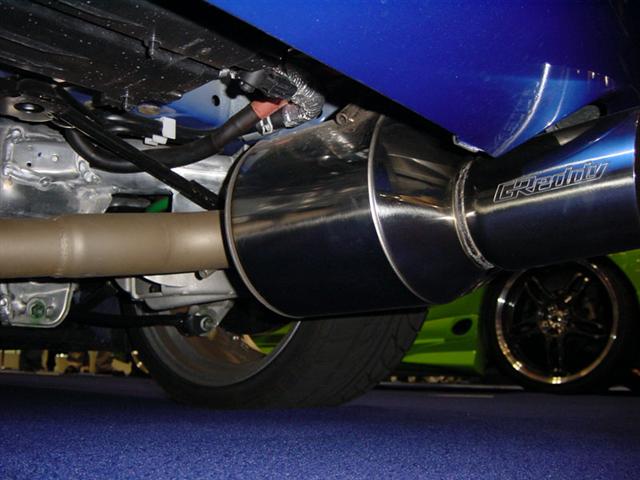

  #58
zxsaint's Avatar
zxsaint
Fairlady Stalker
Posts: 2,860
From: Studio City, CA
pipage
Attached Thumbnails Finally! Hard Numbers on the greddy kit-ias12-small-.jpg
