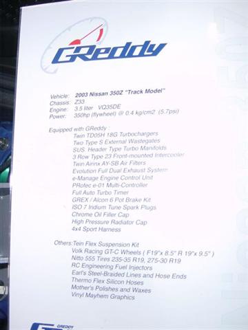

Originally posted by 99AllTurbo
That's not what the new Turbo magazine issue is saying. The Greddy 350Z is on the cover and it says 334 whp @5.X psi
It's still good. The article says its 89.XX more wheel hp than what it dyno'd stk.
That would calculate to only 4% drivetrain loss based on their new stats they had on the car at IAS (350hp flywheel @ 5.7)
Looks like they're still tuning it up and down quite a bit -- probably looking for something that will get them CARB certified with max gains.
