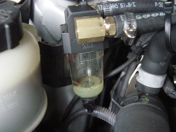

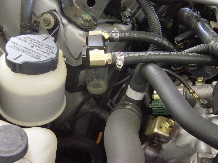

Stormcrow agreed to help me get rid of this knocking sound I was having in my engine. [that's his sweet-looking red Z in the first couple of pics].
He ended up adding this catch can to the hose running from the pcv system to the plenum to catch oil that was getting sucked into the plenum and diminishing my octane rating. (the lower octane rating was throwing off the timing, causing me to have the pinging noise and taking away engine power).
the first image shows the catch can (genius idea) after the install and the next image shows the catch can after my 15 minute drive home from getting the catch can installed. As you can see, I already had oil in the catch can after only a 15 minute ride.
We also added racing fuel to the car and the pinging was completely gone by the time I got back to my apartment.

jeremy installed the catch can for me on saturday. i've done a fair amount of driving this weekend and the knocking is gone.
i was worried that the knocking would come back after the racing fuel burned off (we added 3 gallons of racing fuel to an empty tank to clean out the plenum). sunday morning, after all the racing fuel was gone, i filled up with 93 octane at qt and drove it a lot of the day sunday--still no knocking. i now have about an eighth of an inch of oil in the catch can.
i'm confident the knocking will not come back because before the install, i had the knocking sound all the time. there was never a time when it didn't knock if i just listened closely.
i'll take a couple more detailed images of the catch can with the hose so you can see how it was constructed. jeremy bought the parts at home depot.
the green stuff at the bottom of the plastic catch can is epoxy, which he added to seal off a valve that came with the catch can. the install was super-super easy and quick. i'd say the hardest part would be finding those parts at home depot and putting the little contraption together.
