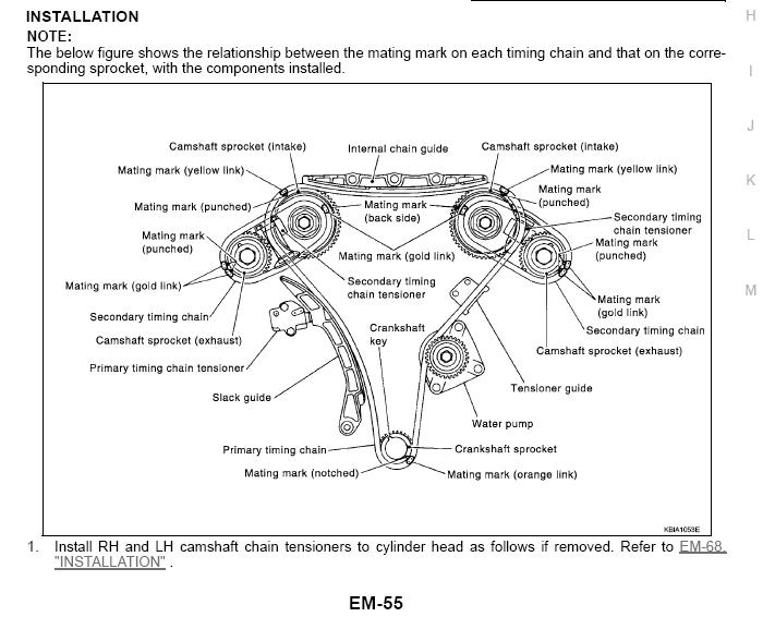

got the valve cover off...turn the crank and the exhaust cam does not move...
is it possible to switch the cam gears in the vq????
thinking i may have

I do not know if it is possible to mix-up the cam gears, sorry.
But I have broken camshafts before.
Sounds like you have a catastrophic problem. Keep us posted.
Attached Thumbnails well crap... :(-cam.jpg
Old Oct 5, 2007 | 11:53 AM
INTIMAZY's Avatar
INTIMAZY
Posts: 929
From: Staten Island / NYC
Missed a few teeth when putting the timing chain on maybe?
No clue, I know my friend had his mustang do that on him and it sounds almost exactly as you described. He ended up bending an intake valve. His is an interference motor, however, so not sure how much that helps.
The part where you mentioned that it happens every second or two seems like it would be on the valve side since the cams do 1 rotation for every 2 turns of the crank...
