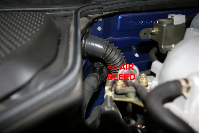

How did you purge the system? I'm also swapping out my Rad and Thermostat next weekend. In preparation, I found this:
"Do not bleed the air at the radiator. There is a bleeder on the passenger side inline in the hose behind the engine near the fire wall. Run the car and then turn the screw a few turns eventually you will see it bubble until coolant comes out not just air. Close and let run for a couple more minutes and do this again. Repeat as needed."
I pretty much went by this DIY that I found... http://crackaddict.com/~flynn/howtos...amco.howto.htm

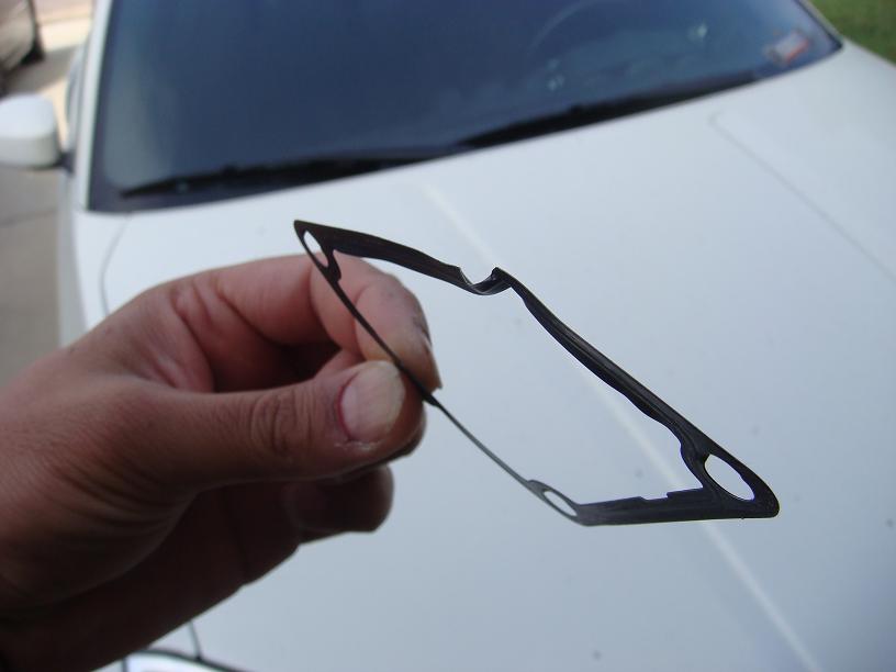

When you replace the thermostat make sure the gasket sits properly otherwise you will jack up the gasket like I did and have leaks. What I did with the second gasket was that I added very little dabs of RTV silicone sealant to the thermostat so the gasket would stay in place.
And run the Heater
Awesome write up! Very informative. Thanks!
Originally Posted by Eazzzzzzy
And run the Heater.
Will do. Thanks!

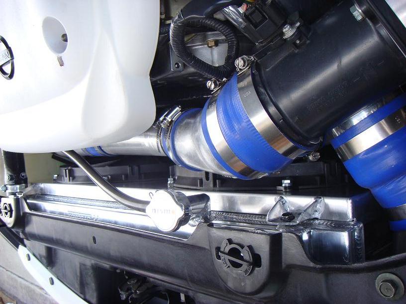

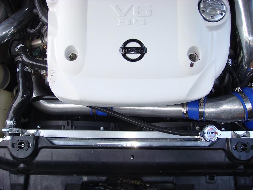

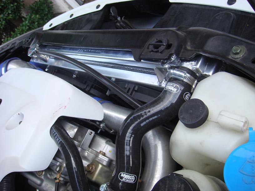

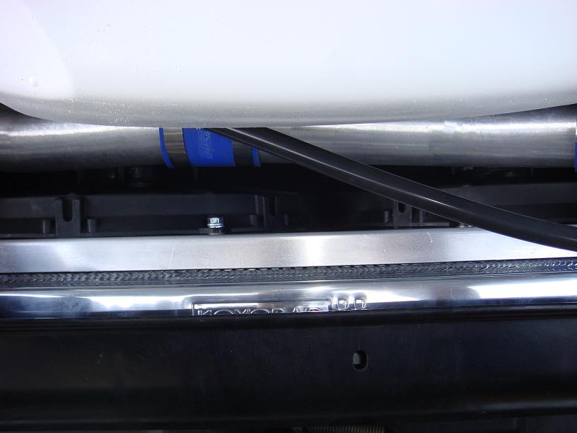

Here is some pics: the first is what happened to the first gasket, the rest are after install and complete. Enjoy.

Friggen nice (and clean) engine bay!! A work of art!
Thanx.

+1
Very clean & professional looking indeed!! :-)
