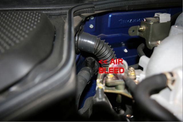

Yeah, bleeding it through the heater bleeder vent next to the firewall worked for me. Level ground is fine.
For your scanning needs; I bought one of these at Advanced Auto for $40 dollars. It scans for active & pending codes, erases codes, and resets the CEL. It's been an inexpensive worthwhile investment.

My car was up on jackstands at the time. I actually poured water into the bleeder vent until it was full. The secret is to pour slowly so the air can gurgle and bubble out. Then I made sure the radiator was topped off. Started the car, let it idle. Revved it up a few times. Let it cycle completely through one fan cycle just to make sure. Shut it off. Checked everything again.
Then I drove it normal, checking the res every so often. I had to top the res off a few more times over the next few days as the last reminents of air made it's way to the res.
A good way to tell is to run your heater. It should warm up pretty good if most/all the air is out. Also, the factory temp gauge only polls the sending unit once every 60 seconds...
Edit: I'm running about a 60/40 mix of distilled h20/antifreeze.
