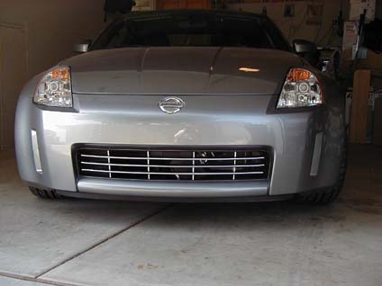

Oh yeah.
Heres a pic of the JWT down in the grill.

Old Jun 18, 2003 | 10:14 PM
slay2k's Avatar
slay2k
Posts: 1,235
From: Los Angeles
Cool beans.
I'd like to get an Injen, but it's been raining buckets lately here on the east coast, and I've driven through a few decent puddles...
It'd scare me if I had to worry about flooding the engine everytime it rained hard.
