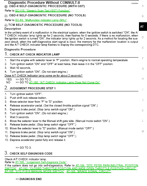

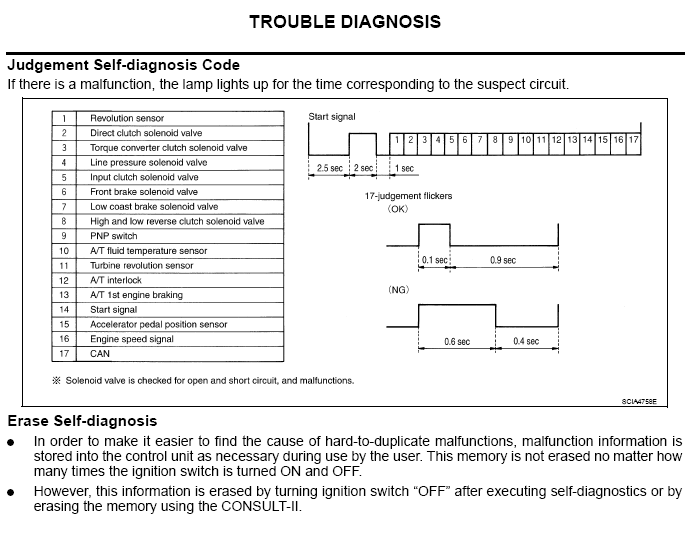

I've attached two images out of a FSM for a 2004.5 G35 5AT for diagnosis without any tools. Maybe it'll help you isolate the glitch. I'd consider trying a stock valve body to see if the issue resolves (if you haven't already).
Good luck!
Good luck!
Thanks man. We have all the service manuals, but I don't remember seeing the self AT diagnosis. Might give that a try.
