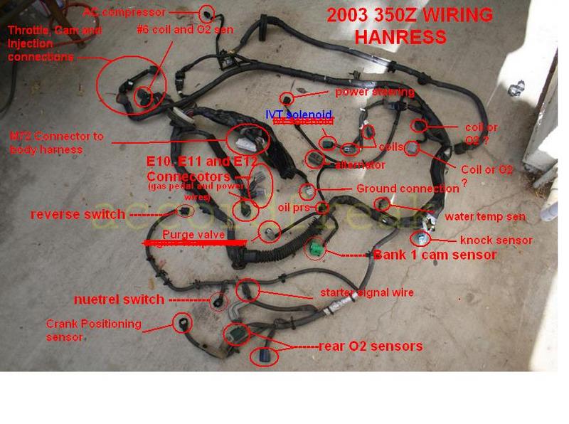

ok gonna buy a used engine wire harness from a member here on my350z.wanna know if this wire harness would fit on too an 03 VQde motor with no issues?? I got pics here from the member..please help me put guys...I wanna get my VQ swap done for my 180.....

It's not a rev up harness, and it is for a 6MT.

There was no RU in 03, so no IVT for the ex. cam, and there are no TCM connectors.
The ECU would be the one to ask if it has VDC or not.
