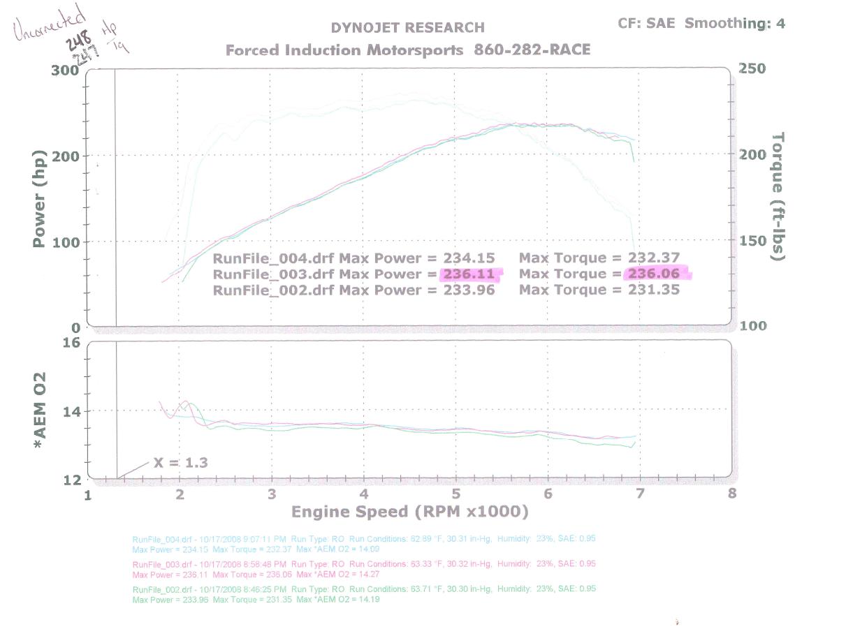

Here is the graph, I was way off on the humidity, thats what its like here in the summer, not October! Best corrected pull was 236/236 in 4th. Pulls 2 & 3 are 4th gear and the 4th was in 3rd gear. Looks like I could lean things out when cobb finally lets Z's get protuned.

A dyno is a tuning tool. Dont use it to compare your ed!ck to others. If somebody else puts down 255whp SAE stock, dont feel bad, they are all different.
Your numbers are normal, if you had done research you would know that instead of coming on here looking for support or answers. Do you want us to tell you the car is weaksauce? BTW-every Z is different but my car always put down more power in 5th than in 4th...it made no sense but that's how my car works.

Well good to hear my Z is running well, thanks for the feedback guys.

I think the AccessPort map notes for stage 2 specifically says no intake modifications, headers, high flow cats, and catback; and the newer stage 2+ is everything above, and also includes intake kit, and plenum spacer. Technically speaking, your set-up is not supported by any of the off-the-shelf maps. Did you try the stage 1 map too?
I really wish Cobb would put out the protune software. I am using a plenum spacer and catback, which is a combination also unsupported by their current map selection. I don't think I'd get one until they release the protune.

After talking with cobb the stg 2 map is fine as long as you check your AF and I'm not running lean. They have to cover themselves because some mods cause the engine to run leaner by nature, then the map leans things out a little more. Otherwise in the unlikely event someone blows their engine because an intake leaned things out too much they could theoretically go after cobb. From my understanding the 2+ map is a little richer to prevent a lean condition, I could be wrong tho. Apparently the protune software should be getting released in the next few months, then the AP should prove to be worth every penny.
