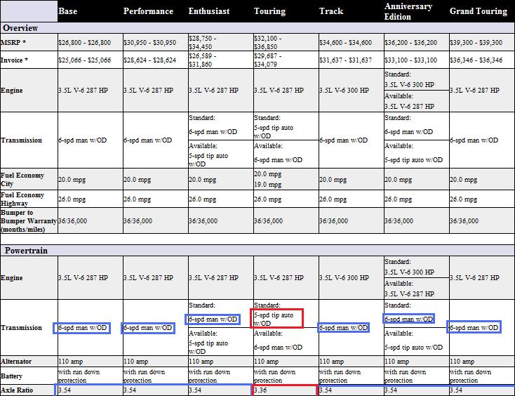

learn how to read the spec sheet bud! Here it is highlited to be idiot proof. Take a good look at it!

i think you need to learn how to read it! still says 3.36! where does it say that the manual is 3.54? it doesnt because it is 3.36! look at the others that offer auto tranny. they also say 3.54! the touring model whether its auto or stick is 3.36

No, look closer. It gives the final drive ratio for the transmission that comes standard with that trim level (aka it doesn't list the final drive ratios for both available transmissions, only the one that comes "standard"). In this case the standard transmission for a touring is the 5at (touring is the only one that this sheet states comes standard with a 5at) therefore it lists the final drive ratio for a 5at. All of the others come standard with a 6mt and some have the 5at as an option, but it still lists the ratio as 3.54 because the standard transmission on those trim levels is a 6mt even though the available 5at comes with a 3.36.
Whether or not you comprehend or want to listen to what I have stated, it is widely known that all 6mt equipped cars come with a 3.5 diff and the 5at equipped cars come with a 3.3 diff.
