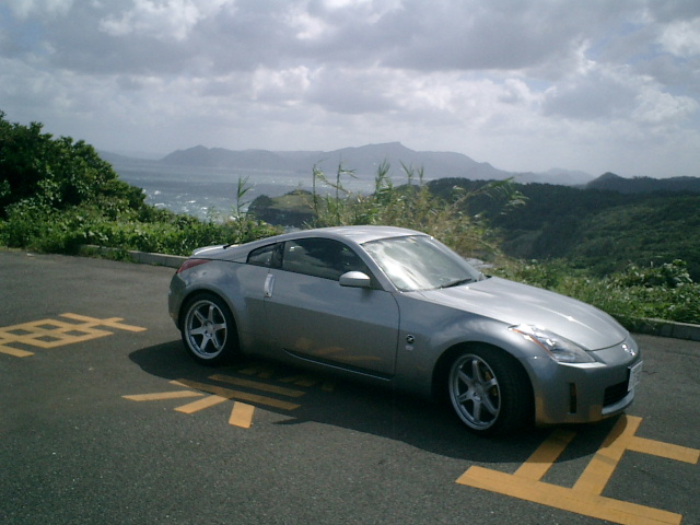

My Impression After 600 miles driving the new Sports Resetting System
I have put over 600 miles on my Z since getting the “sports resetting package ” installed. I have done 3 road trips .. a beach sweeper to the outer islands of Japan, a mountain course with sharp, switchbacks, and a backroad twister course consisting of bumpy and easy-to-sharp curves.—all including some expressway travel.
I simply love it. The spool-up to around 3,400 RPM is smooth and quick. From 3,400 RPM flat up, the acceleration is terrific, fast, smooth, and the exhaust/sports cats get wild – the sound builds dramatically…and it is simply exhilarating as the speed comes on so quickly.
Initial impression is still the same… shifting is smoother, bam…hit the accelerator … spool up … bam – you are at redline. Shift.. the NISMO flywheel holds the revs… bam … hit the upshift around 3,500 – 3,800 RPM… bam…redline. Downshifting is smooth and effortless… the flywheel offering a lot less engine braking..
I would buy this system again in a heartbeat. Total satisfaction. !!!!
