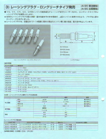

Here is a brochure I received a number of months ago from NISMO... and contains some info regarding the "long type" racing plugs. I don't know the maker, but I will try to find out. Toward the bottom, the specs for the racing plugs (left side) are compared to the regular plugs. Replacement plugs are recommended every 12-13,000 miles per NISMO.
