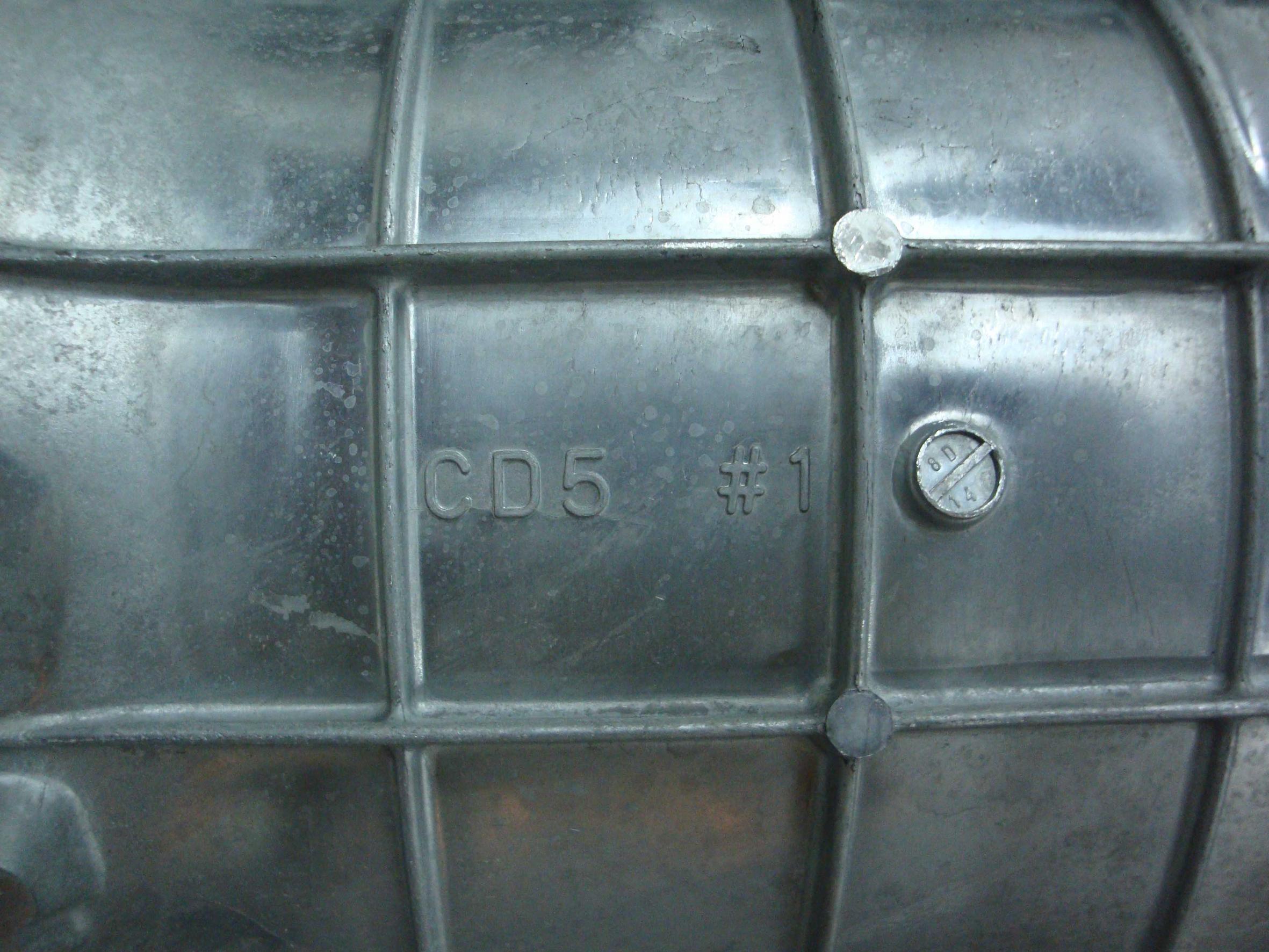

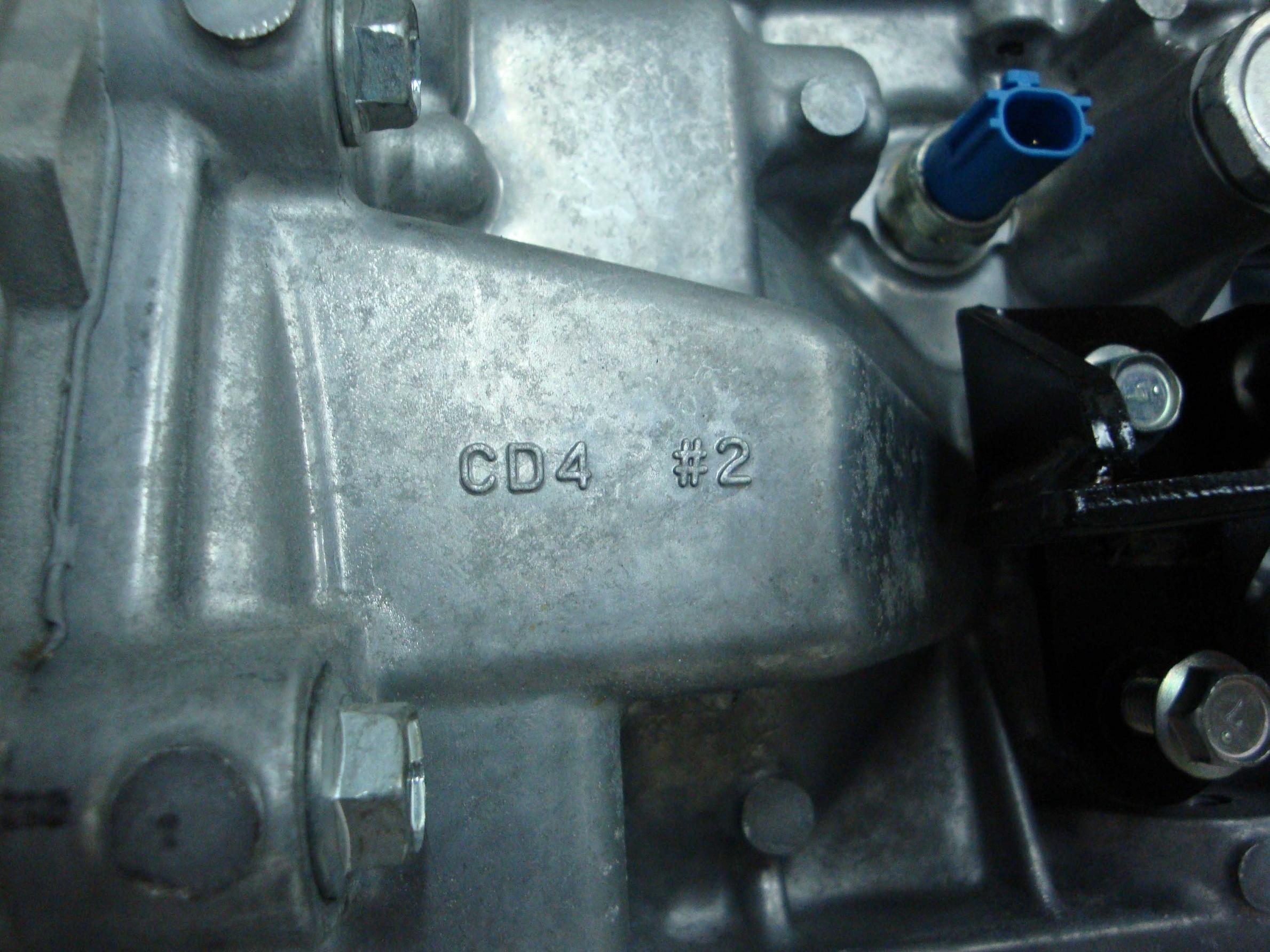

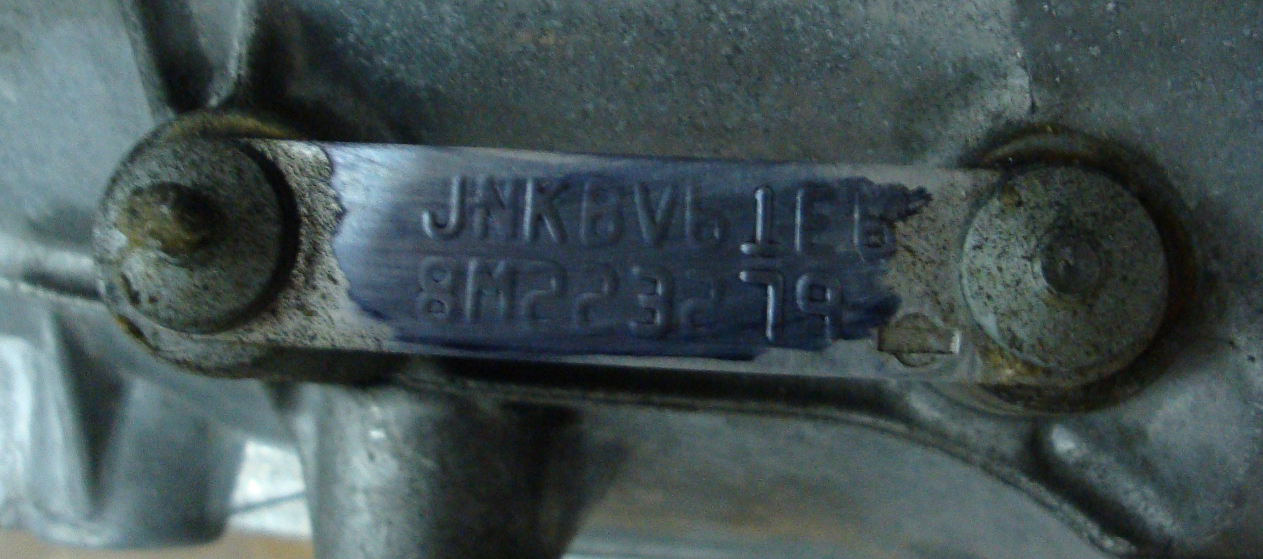

okay, I just got some more info about the trans I am thinking about purchasing and its actually from '08 by the vin that is on the trans. Will this still work on my car? Here is the pics I have of it...
07 and 08 350Z transmissions will not bolt up.
07 G35 Coupe Transmissions will.

okay from what I know now it is a G35 sedan trans from '08 with 7K miles... The pictures above are the stamps and numbers on it... Will this work in the 03 350z?
