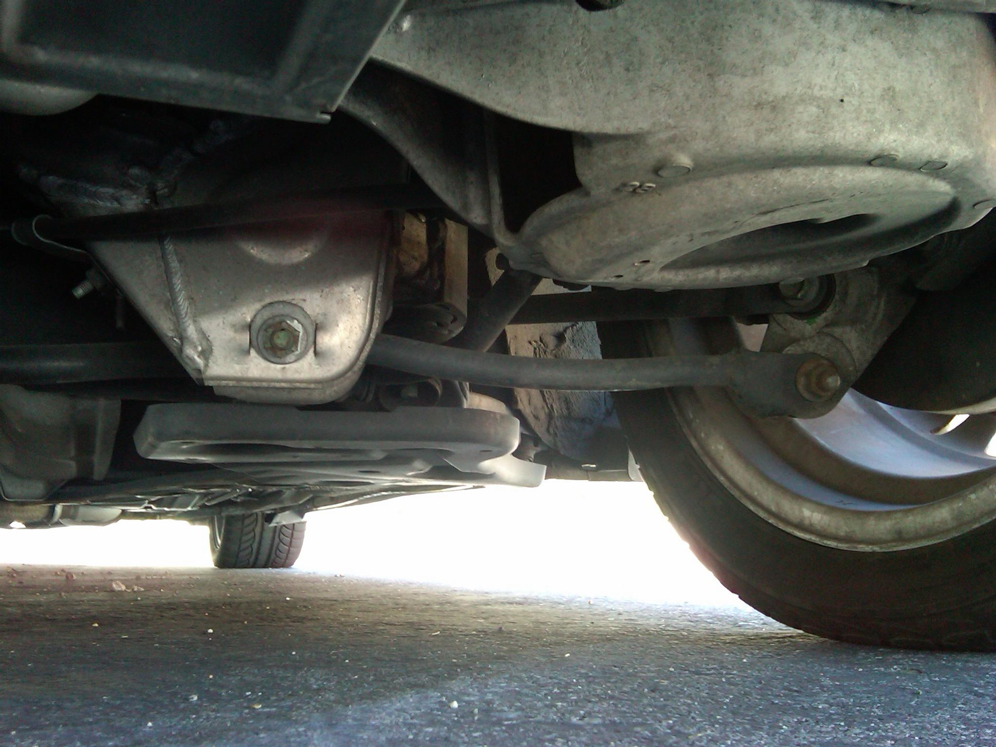

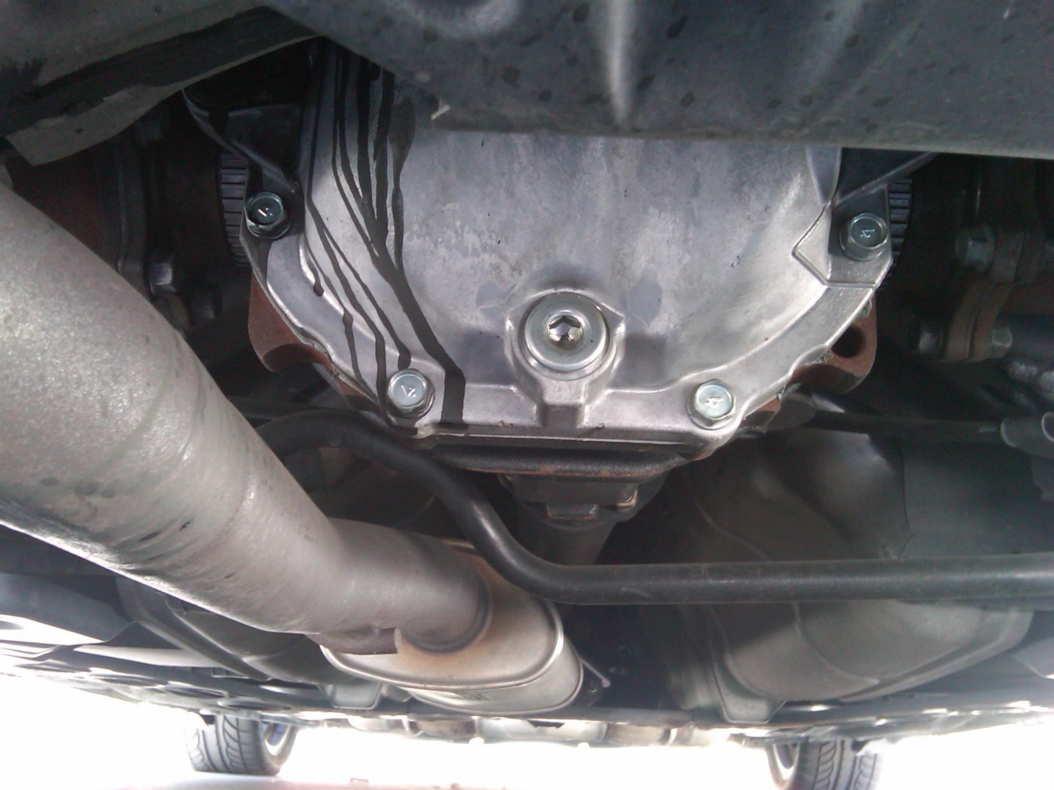

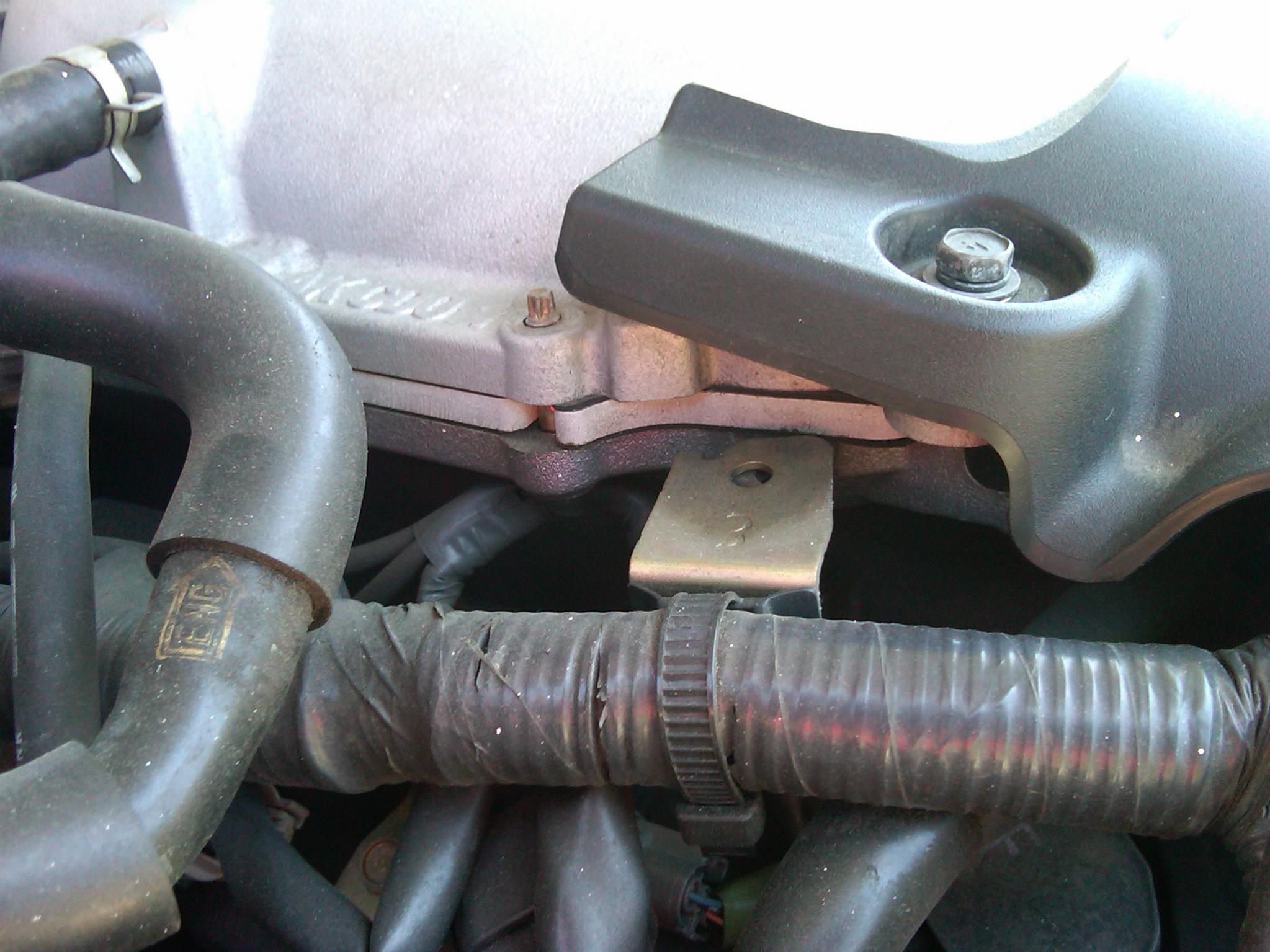

Hey the spacer on your engine is called a plenum spacer (search for it on this site for more info), although it may not be installed well. That missing bolt is to keep your wiring harness snug, he probably left the bolt off doing the spacer install.
Also your differential looks like it's leaking fluid. You may want to get that checked out

I just talked with my brother earlier and he gave me the name, and I've been researching that spacer since I posted it. The differential doesn't leak, I checked that when I took the picture. It's weird it's seems to be some kind of sealant.

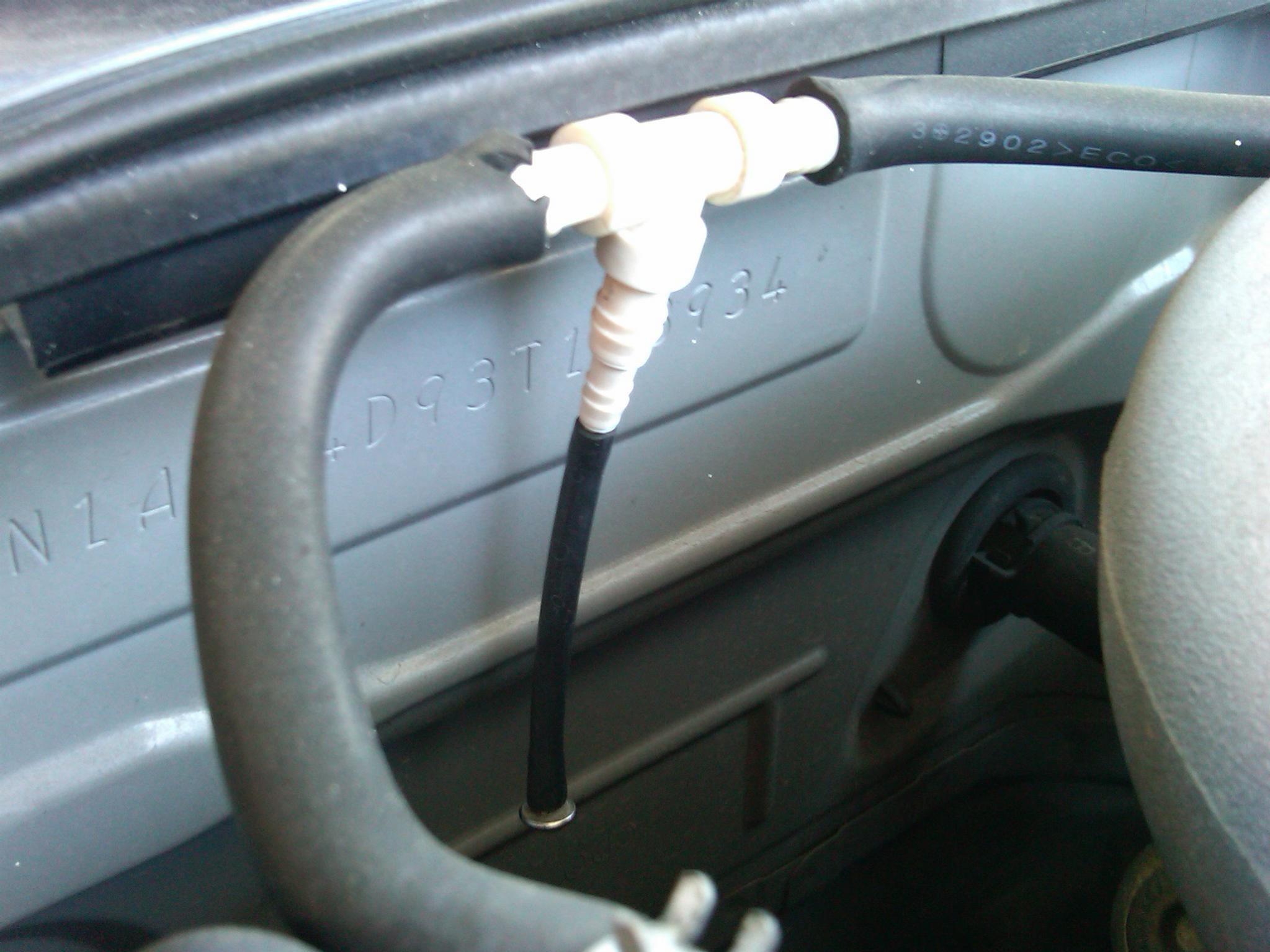

Can anyone explain the thing that connects the two hoses in the engine bay?

Doubt someone would swap the steering wheel, looks like you have an enthusiast. As well looks like your Differentials liquid filled bushing popped, hence the liquid leaking down on your pumpkin. I'd suggest getting the SPL solid diff bushing to replace the liquid filled rubber one.

most likely for a boost gauge, it looks kinda crudely done, too. as for the black goo dripping down on the back of the diff my 350z had that too and mine was stock, i think it was from a bushing blowing out or something

That hose under the hood has been cut and spliced with what use to be something else.

yea seem like you have a plenum spacer already installed. Plenum spacer raise the height of your intake manifold, which allows more air into the engine. More air = more power! its dyno proven! Its a popular best bang for the buck mod on the Z.
The T connector looks like it was previously cut to use with some gauge for temp monitor. But i guess the previous owner decided to removed it and connect the hose back.. Shouldn't be a problem in the future.

Black liquid on the differential cover looks dry. May just a sloppy installation or repair.

Not sure what the T is for. Vacuum gauge? You can pull it out and connect the hoses properly.
Yes definitely the diff bushing........follow the gunk up and you will see its most likely not coming from the diff, but from one of the diff bushings.......
Do a search and you will find threads on diff bushings blowing and very similar pics to yours where the sealant goop has slowly leaked down over everything.
