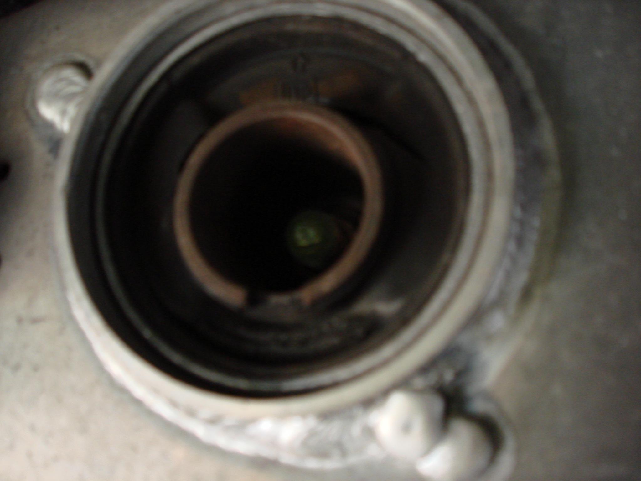

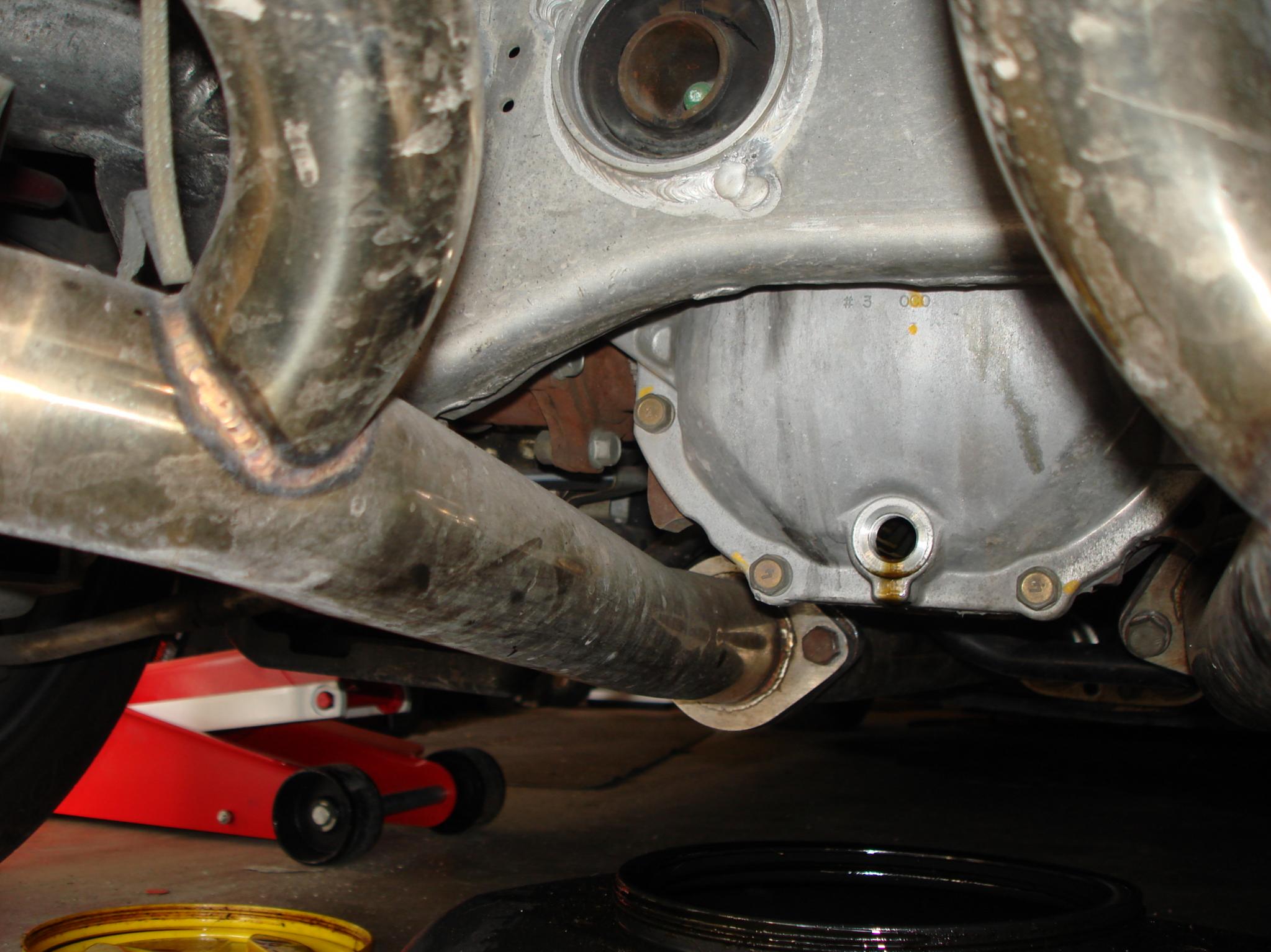

Was changing my diff fluid and noticed this!!
I just got done changing my control arm bushings because they were shot and now its this. Im getting sick on Nissan Rubber.
Anyone got any info on this or expierence with changing it? It looks very tough to change.
My car has 98,500 on the clock.

Now listen, listen to me: this is extremely common. it is an easy fix.
Here is what you do: buy the 'SPL solid differential bushing kit' (front and rear kits) and replace them. while you are doing that, you should replace the subframe bushings as well, since your car has a lot of miles on it. It is an easy swap, but it requires a few hours of taking things apart is all. if you are not mechanically inclined, pay a shop to do it.
Contact 'Z-1 Auto' to buy the parts. it is well worth the upgrade.

your car is 6 years old and it has a lot of miles on it. That is a high stress part as it is constantly resisting the diff twisting out. It is made of rubber and is on the underside of a vehicle. it is not ridiculous, it is not Nissan's fault, and you sir need to just fix it with the bushings that Motormouth suggested because they are the ****.

90 thousand miles is a long time remember, it probably dried out, then cracked. that is why instead of replacing it with another stock unit that will do the same, you should get the solid differential mount to eliminate the problem, and improve handling.
the bushing can tear in a very short amount of time if you drive the car hard, or do drag launches and such.

The subframe does not have to be removed to replace the diff bushings (I believe Motormouth did his awhile ago while the subframe was still installed in the car, correct me if I am wrong) but for the subframe bushings you will need to drop the subframe. Which in itself isn't the most tedious process if you have the right tools (air tools, crepper, tranny jack, etc.) In the Factory Service Manual it gives you a basic outline of how to remove the entire rear suspension as one piece including the rear subframe, upper and lower control arms, spindles, etc.

To just replace the differential bushings, you do not need to drop the subframe. All that is required is to remove some exhaust components, swaybar and the differential+driveshaft. Once those are out of the way, you can hammer out the old bushing and then insert the new bushing. SPL does not provide instructions, but the FSM instructions on the removal/installation can be followed. The only advice I got from Kuah way back when was to put the bushing into the freezer (to compress the aluminum) and then grease it up with dishsoap, to ensure an easy installation. I thankfully had access to a lift myself, and could see the job taking about 4 hours start to finish for someone who has not done it before, taking your time, if you don't run into any problems like a stripped bolt.
However, it will be easier, in case you run into issues (which is possible, especially since the car has 90k miles, metal gets sticky) to just prepare for it and drop the subframe in the first place. Then, you can use a bushing press to get the new and old bushings in/out with accuracy, instead of hitting it with a hammer. This also gives you a convenient excuse to install the Whiteline subframe bushings. >wink<
As you said, "the car doesn't feel like it should", and that is due to both material fatigue in the subframe, and in the loss of control of the differential, since its motion is supported only by the one bushing in the rear. The bushings are very inexpensive, and you are already doing the disassembly work.
