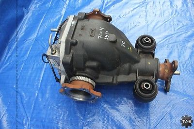

BUMP...so i can buy a diff from a automatic g37 vlsd and swap it into my 350z?
all i need to do is swap the part where the drive shaft bolts too?
