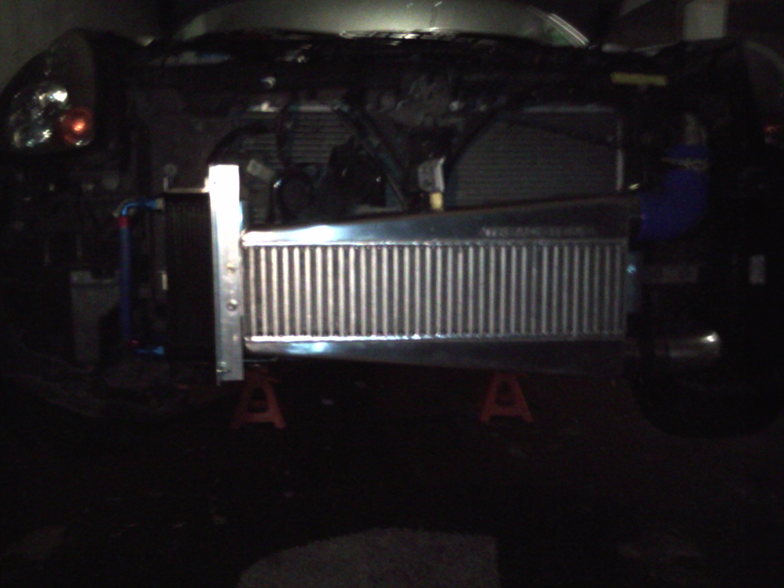

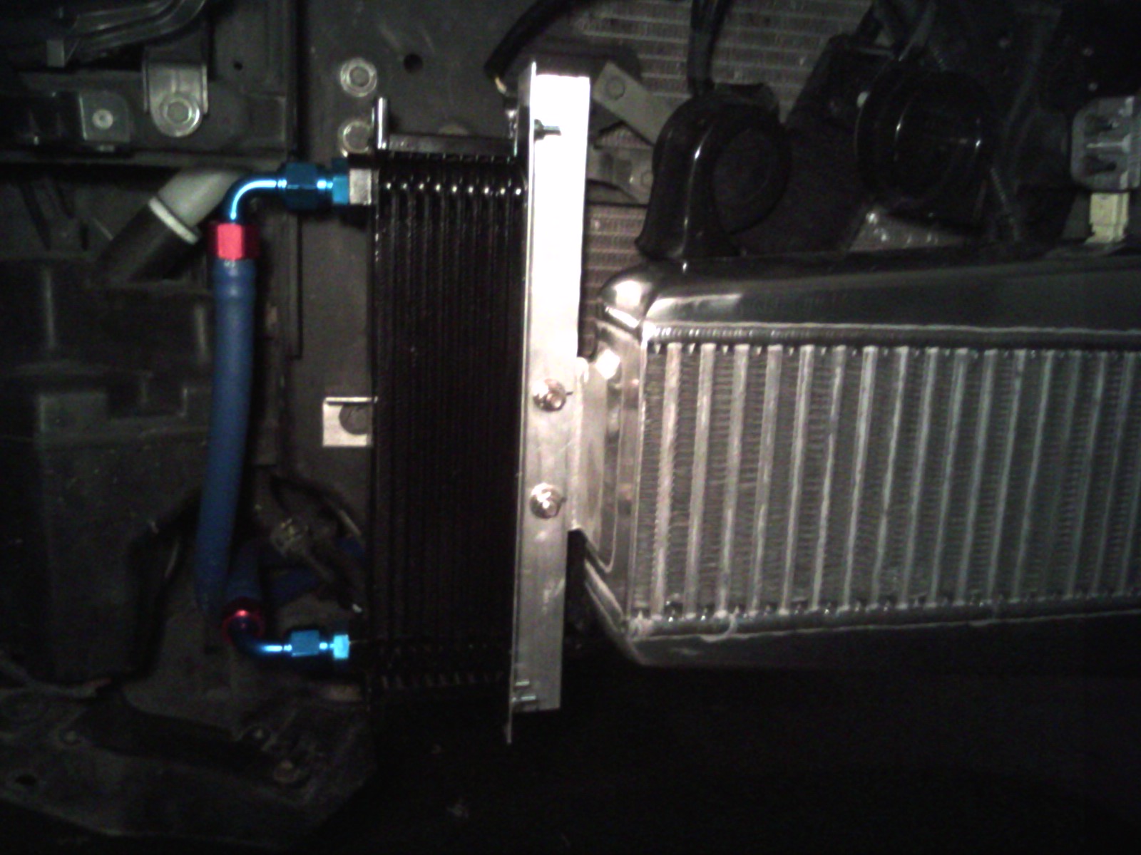

here are some bad pics of mine. earl's cooler, 8 an summit twist tite lines, mocal thermostatic plate.

Have either of you had any leaks with the cooler mounted vertically? and when you change your oil is it required disconnect and drain the cooler as well?

leaks?? you shouldn't have any leaks no matter how you mount the cooler. I used all the proper connections and so far 2 weeks of zero leaks or trouble. since it's mounted vertically and above my oil filter when i remove my oil filter the oil from teh cooler will drain from the bottom line out of the sandwich plate. No issues with changing the oil at all. Another reason i chose to mount it that way.

and that's just a cheap piece of aluminum angle i bought at lowes. easy and simple.
