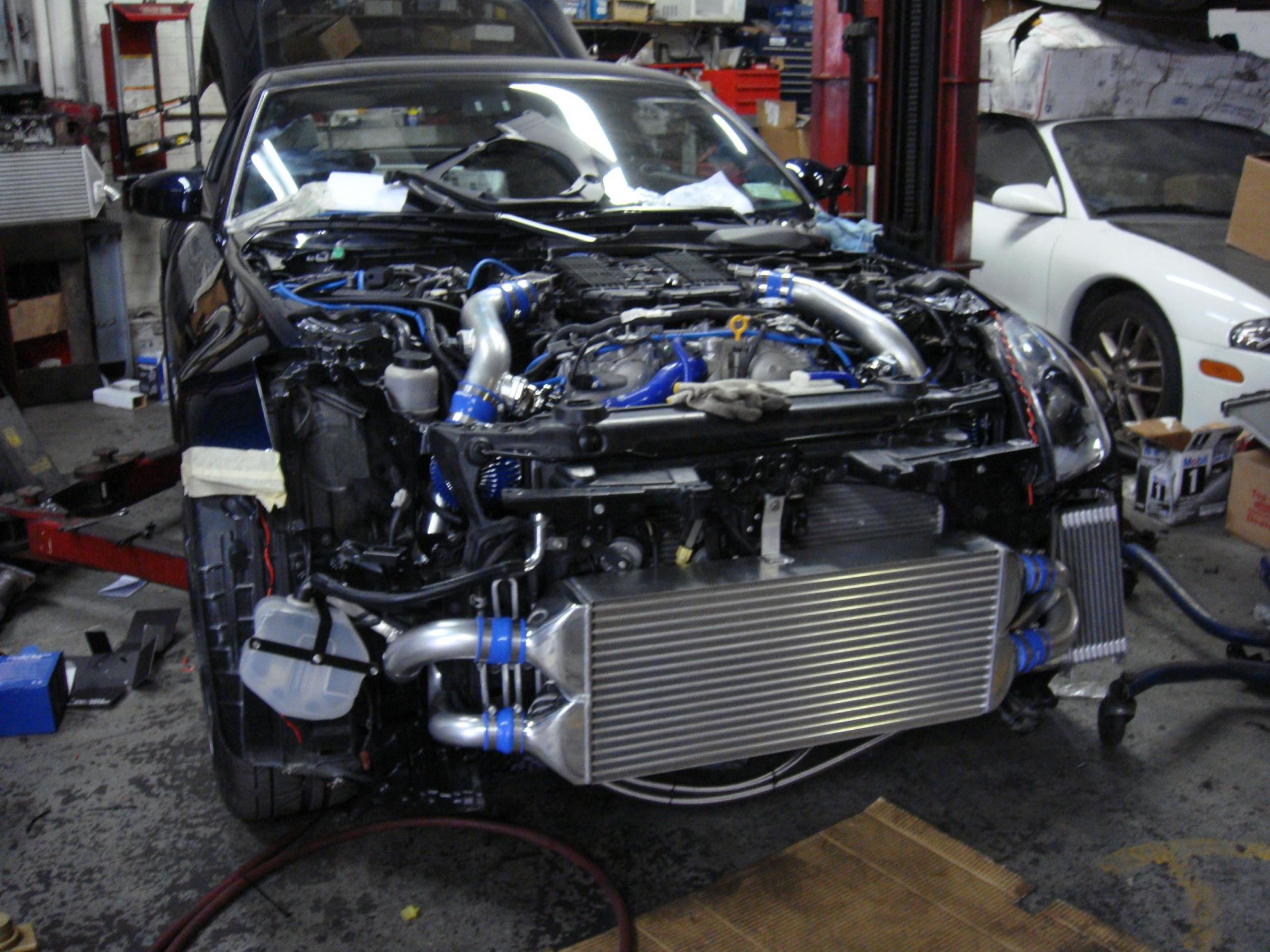

Mishimoto oil cooler. The fittings leaked after 30 minutes. Swaping out the lines and fittings..
Old Jul 25, 2010 | 03:32 PM
  #75
binder's Avatar
binder
Posts: 6,457
try tightening them?
why would fittings leak so easily? what brand are they?
