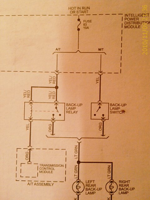

Here's the backup light wires, looked for Y/O wire and could not find one. The closest is this

Thanks for the help guys. I found what it was and it is the back-up lamp switch. It is connector F36 on the engine harness with the wires Yellow/red and Orange. It was my mistake for think that the stripe on the wire was orange instead of red. I feel dumb now.

This is the connector to the switch on the transmission that indicates the car is in reverse gear, not the back-up lights themselves.
