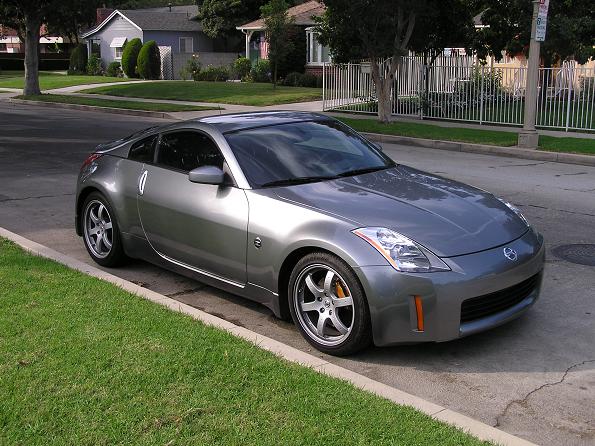

Default That's My Set-up
I have everything you are planning for your N/A car, except the LSD. Question: what is wrong with the stock LSD, and how will an aftermarket one improve performance? Thanks.
P.S. Yes, it's me. Don't need any masters of the obvious pointing it out. Where are my 2 strikes? lol
