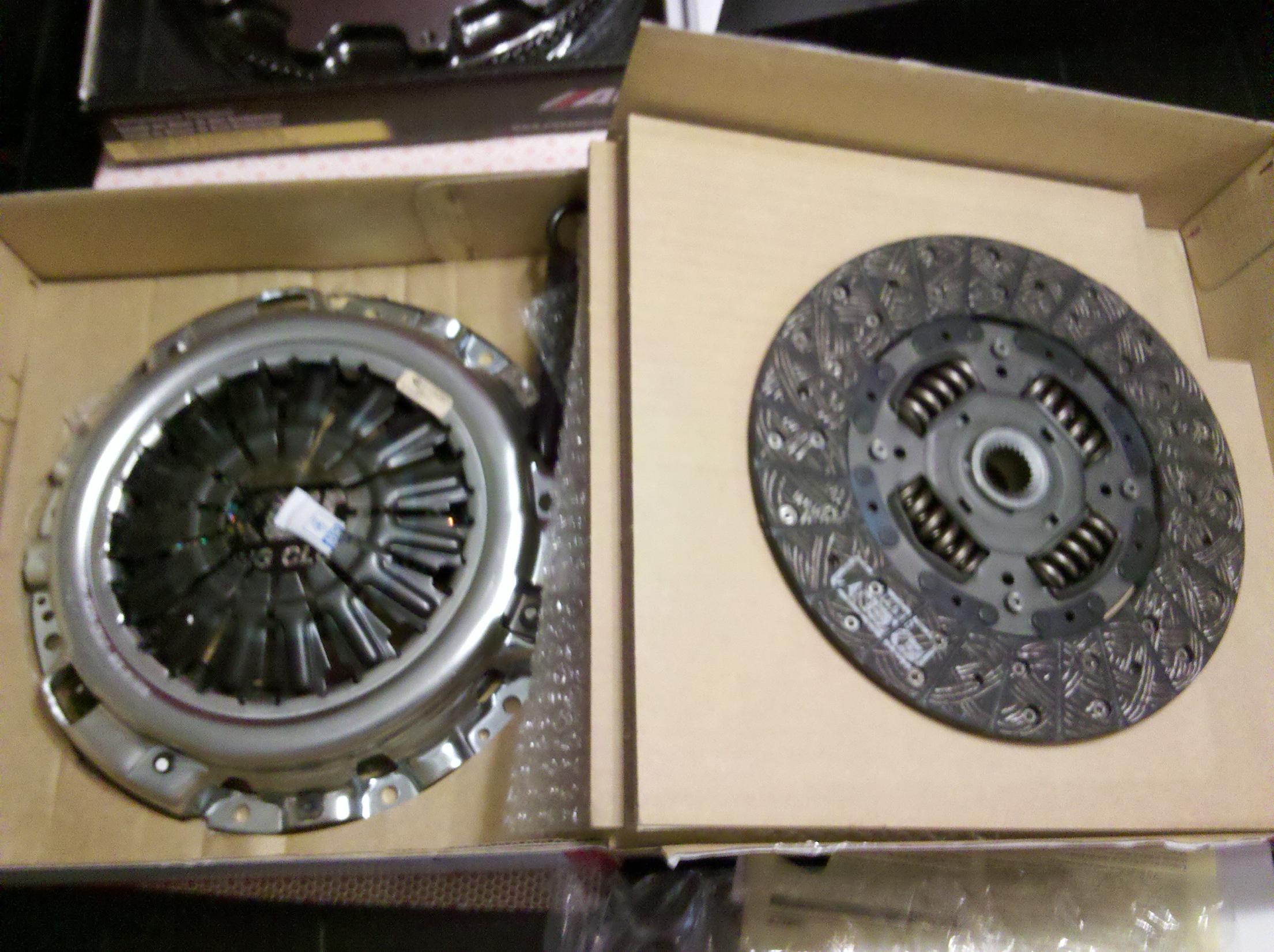

Exedy stage 1 clutch:
I don’t plan on adding forced induction or nitrous. I just want a little more clamping force with a stock like feel. The Exedy stage one racing clutch seems to do that well. It uses a stock sprung organic clutch disk with a more aggressive clutch pressure plate. The additional grip is great, I could probably add a nitrous kit or stage 1 supercharger without worrying about slippage. I believe it’s rated at 300-350 foot pounds of torque. The clutch pedal feel is slightly stiffer, but just slightly. To be honest I like the firmer feel. It’s not to grabby, some of the more aggressive clutch discs (puck) are very hard to slip. They seem to be like an on/off switch which makes the car hard to launch slowly. Because this kit uses a stock organic clutch disk it’s still very easy to engage smoothly.

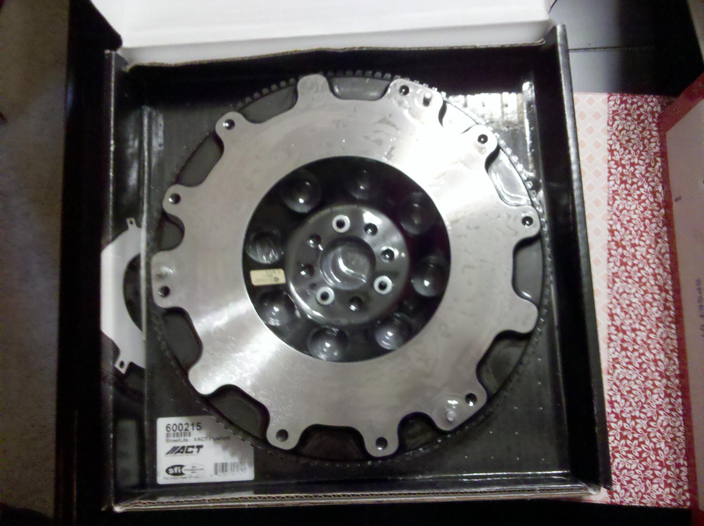

ACT StreetLite flywheel:
I went with the StreetLite over the ProLite because of drivability. I had already dropped weight at the rotating assembly with the crank pulley and didn’t want to take it too far. The flywheel is steel, nothing to fancy. It’s a single mass flywheel so I could have it re-surfaced when I put the next clutch in. All of the single mass flywheels for the 350Z/G35 are prone to some degree of chatter. The stock flywheel is a heavy dual mass flywheel. Dual mass flywheels have two heavy masses that can move independently up what looks like about an inch. The two masses are sprung which helps to absorb vibration, reduce chatter, and smooth out engagement. The weight of the stock flywheel makes it easier to launch because of the inertia it generates.
Chatter:
The single mass flywheel does cause some chatter. What you’re hearing are gears rattling. The sound is no longer being dampened by stock flywheels weight and dual mass vibration conciliation properties. In my opinion it’s livable, I haven’t even noticed it lately. I’m not sure how the even lighter JWT and ACT ProLite flywheels contribute to chatter.
Weight:
It revs much faster and I honestly feel like that car accelerates harder. You can feel the car in relation to the gas pedal. For those of you still on stock flywheel you’re probably not even aware of the slightly sluggish responsiveness. A couple minutes behind the wheel of a Z with a lightweight flywheel and you’ll instantly be aware of how much better it can be. If you heal toe your down shift this is a necessary mod. It’s now much easier to blip the throttle to bring the revs up.
The downside to the weight reduction is drivability. The lightweight flywheel doesn’t carry the inertia of the stocker so you need to rev it a little higher before engaging the clutch. This makes the car a little easier to stall when the revs are low. I’m sure it will only take you a couple days to get used to but your chick probably won’t like driving your car anymore. I can also see this being an issue when trying to sell the car down the road. Your potential buyer may not be too savvy with performance clutch/flywheel driving.
