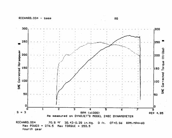

Richard 350z has authorized me to post his dyno sheet from the Dynojet run today. Here it is.

Still very very nice HP and in line with what everyone else here is experiencing with these mods.
Good to see the numbers up, thnx Richard!

Do you have the af readings available from this run?
I don't want to believe these mild of a cam will rob any low down torque. More torque should have been had from 2500-5000.

was his car dynoed in 4th instead of 5th?
bc on that dyno sheet it says 4th on the bottom.

First off, I appreciate Richard allowing this to be posted on this site for us to see and his willingness to share information that he did not have to share with us. Even though Dyno information has a lot of variables it is still a great tool for fine tuning and selecting mods that make HP and torque where you want it.
That being said, I too was suprised by the torque curve and my first thought was, "I wonder what the A/F ratio looks like" The other concern is the borla headers. I have never liked their design and only wonder if they are part of the reason the low end torque is not as healthy as one would expect to see. Just a couple of thoughts. The top end gains are very nice and I bet this car sceams through the gears. Once that final drive is in, you will hit those higher RPMs so fast you will hurt yourself trying to shift fast enough.

I think that 270ish dyno is more realistic. The Mustang must have been way high. Only thing I dont love about R&D's Dyno sheets is they are SAE Corrected.
Jeff and I were talking about going to a different dyno place from now on. We should have taken our cars somewhere that would have done an unrealistic baseline and beyond. heh

Richard informed me that his Dynojet was done in 3rd and 4th gears, but NOT 5th gear. The 4th gear dyno is the one posted. It was a little higher than the 3rd gear dyno.

So if 4th was higher than 3rd is it safe to assume that 5th would be even higher?

dyno pulls should be done in 5th in a 6mt... 5th is the 1:1 ratio gearing...
I noticed R&D does the pulls in 3rd or 4th...
