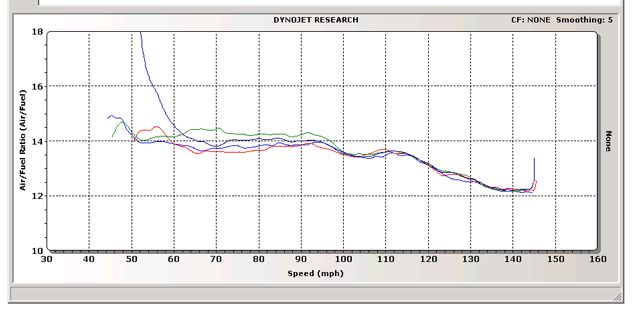

here is my before and after a/f mixtures when I added Kinetix hi-flow cats.
I have injen/pop hybrid intake, borla td, grounding kit and now the hi-flow cats.
seems my air / fuel is the same in all six runs (taking away the 2 really strange readings). Much higher LOWER in the rpm range.

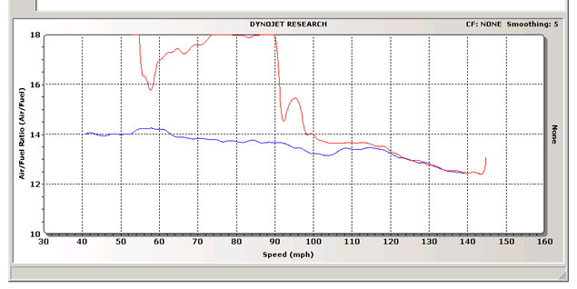

here are the four runs with the kinetix hi-flow cats.
Attached Thumbnails RT cat owners: are you running lean?-a-f-2.gif

after the new plastic plenum goes in I plan on going up to TS for an ecu flash.
Is this a problem that Tadashi (sorry if spelled incorrectly) can fix?
and will the flash help these mods "achieve more"?
Old Feb 4, 2004 | 07:25 AM
  #91
cinergi1's Avatar
cinergi1
Posts: 55
I have the same a/f curve as you all bark and I have the TS ECU flash. Our cars are running very lean up to about 5500 then a little rich to red line. Danny and Tadashi have been working on a solution. Crawford has been helping as well. They are trying to keep it 12.5 to 13 through out the rpm range. Mine is going back hopefully next week to get it fixed.

so they currently do not have a fix but are working on it?
Old Feb 4, 2004 | 09:03 AM
  #93
cinergi1's Avatar
cinergi1
Posts: 55
that's correct

As far as I know the lean problem is being caused by the RT cats. It seems that the ECU takes a O2 reading just before and just after the cats. The RT cats because of their much higher flow are causing the reading taken after them to be much different than the reading before the cats and it seems to be confusing the ECU, at least that is the current theory.
My other mods are crawford plenum and borla TD.
Old Feb 4, 2004 | 12:47 PM
  #96
cinergi1's Avatar
cinergi1
Posts: 55
I have seen many dyno's with the same curve as all bark's. Some have had stock ecu's and some have had TS ECU's but the one common element among all the dyno's that exhibit this lean to slightly rich curve is the RT cats.
