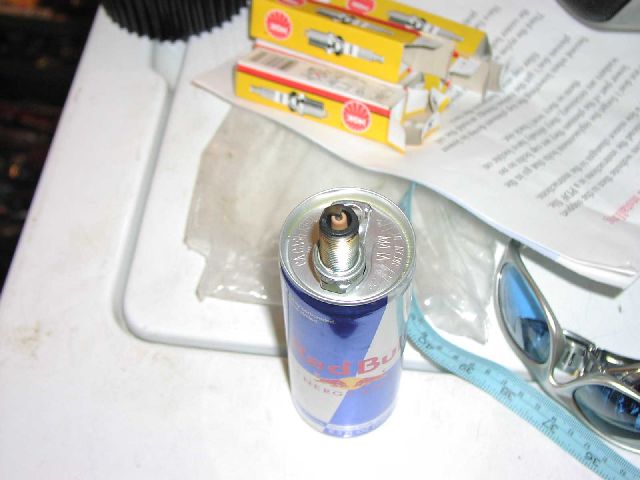

I flashed at TS added the cats etcd several thousand miles ago and just pulled the plug. Porcelin is perfectly tan, engine is healthy, plugs are slightly rich like Jason's. I attribute this to my larger injectors and that I was FI on stock range plats. I now have copper 1 heat range cooler gapped at .37
Anyways, as promised here is my plug pulled yesterday. NOT lean.
Attached Thumbnails RT cat owners: are you running lean?-rtplug.jpg

Looks good to me!
