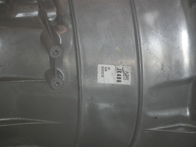

Originally Posted by ffwturboZ
Will this be the same process with a HR to DE transmission? I picked up a 07-08 HR tranny with 9k by seller mistake and would love to swap the inside to my 03 case.
What does the sticker on the side of the tranny say? Should be JK something.

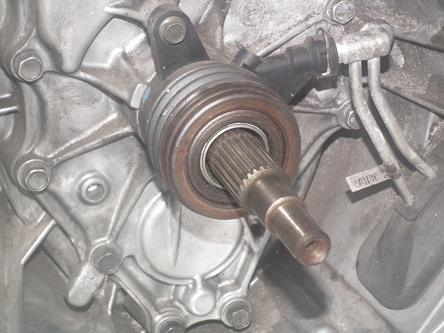

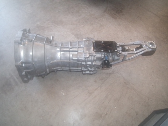

It says JK400 and CD5 on the case. Check out the pics
If I can do the same thing I would go for it like you did..
Attachment 324257
Attachment 324258
Attachment 324259
Ok. Let me do a little research in the software and I will tell you what you have to do. I don't want to steer you wrong. I will reply late late tonight or tomorrow.
Btw, nice tranny! It's in great shape.
