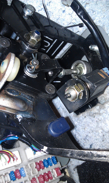

Finally had some good weather. Spent about an hr playing with my bracket and testing out different settings. At 75% was only to get into gear with only about 2 threads in the fork but still felt very blocked and rough. Kept sliding the AFP down bit by bit, turning the clutch rod in a little and retesting each setting by turning clutch rod out. At about 25%, with 2-3 threads in the fork I was able to get into gear much easier. Currently the AFP is at about 10%, slightly above stock, 2-3 threads in the fork, and this is easiest I've been able to shift, still a bit rough but much better than before. I still don't get why I can't get the clutch to fully disengage with the AFP at 75% or atleast 50%. I'm thinking that maybe I might have to bleed my clutch line. Here's a picture of my current setting.

Chillah is that picture of how the bracket is currently being run? When looking at the right hand stud on the master cylinder I don't see the hold down nut clamping the bracket to the master cylinder? In fact from the pic it almost looks like the nut could be underneith the bracket even. The clutch rod angle is fairly low right now as well so the main bracket should be raised slightly to level the clutch rod with the master cylinder.
It should look like this installed. Notice that there is a good 1/2" of threads on the stud with the nut sinched down. Also running without both stud nuts could do serious damage to the master cylinder as the force of pushing the clutch pedal will force the master to move away from the firewall.
I hope it's just the photo playing tricks. If not 100% that nut being off or under the bracket would cause the problems your describing.

It was a bad picture on my part. That black bunch of cables is blocking the view. Both stud nuts are in place and are securely clamping the bracket to the master cylinder. The clutch rod angle is ever so slightly low, not as bad as it seems in the picture though. When I got my car back, with the new clutch installed, the slider was set a little bit higher until my gears started feeling blocked. I'll measure the fork length first thing tomorrow and PM you the measurements.
