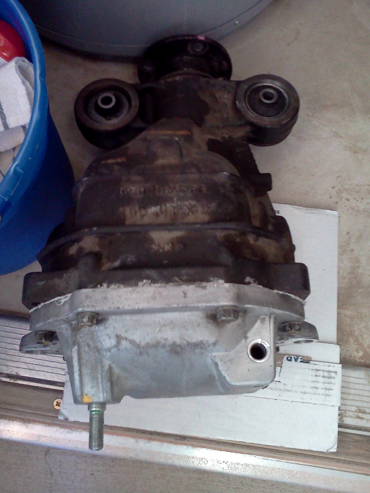

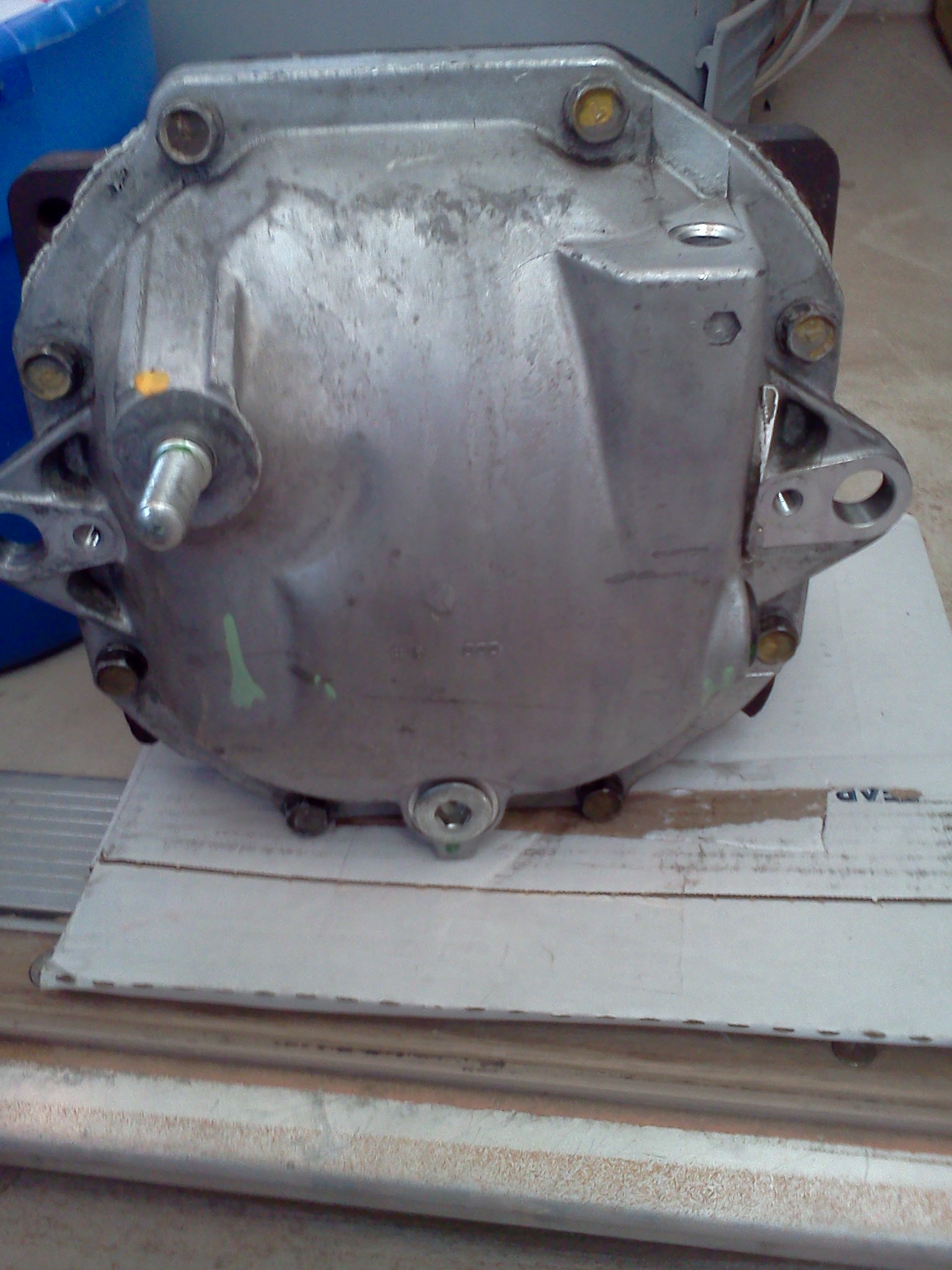

CHANGE OF PLAN:
I acquired a pumpkin (VLSD w/4.08 gears), but no flanges/stub axles.
Looking to build a spare pumpkin-img_20130101_153848.jpg Looking to build a spare pumpkin-img_20130101_153902.jpg
My rear diff bushing is blown, so I want to take the opportunity to upgrade. The plan is to:
1- drop/uninstall stock diff
2- removed stock diff flanges
3- install diff flanges on new/spare diff
4- remove stock bushings (3)
5- install new poly bushings (KDT911 kit)
6- install new/spare diff
7- fill spare diff with gear oil
I'm going to have a shop do the work, but I would like to make sure I understand what needs to be done. I'm concerned about removing and installing the flanges (stub axles?).
Do these slide out (and in - with force) without having to access the inside of the differential carrier/pumpkin? I have searched around and found one thread that suggests that this is the case (2 circle clips required?). So I guess I need confirmation and details. If it's true, I think I will also need a pair of side-oil seals and a breather (missing on spare diff).
2x [38342] DIFFERENTIAL SIDE OIL SEAL
1x [38225+A] CIRCLIP-SIDE GEAR
1x [38225] CIRCLIP-SIDE GEAR
1x [38351G] BREATHER
Any help/input appreciated. thanks.

Old Jan 1, 2013 | 03:51 PM
terrasmak's Avatar
terrasmak
Super Moderator
Posts: 29,138
Likes: 2,402
From: Sin City
Side flanges i just tap out with a mallet. Same with putting them back in.
