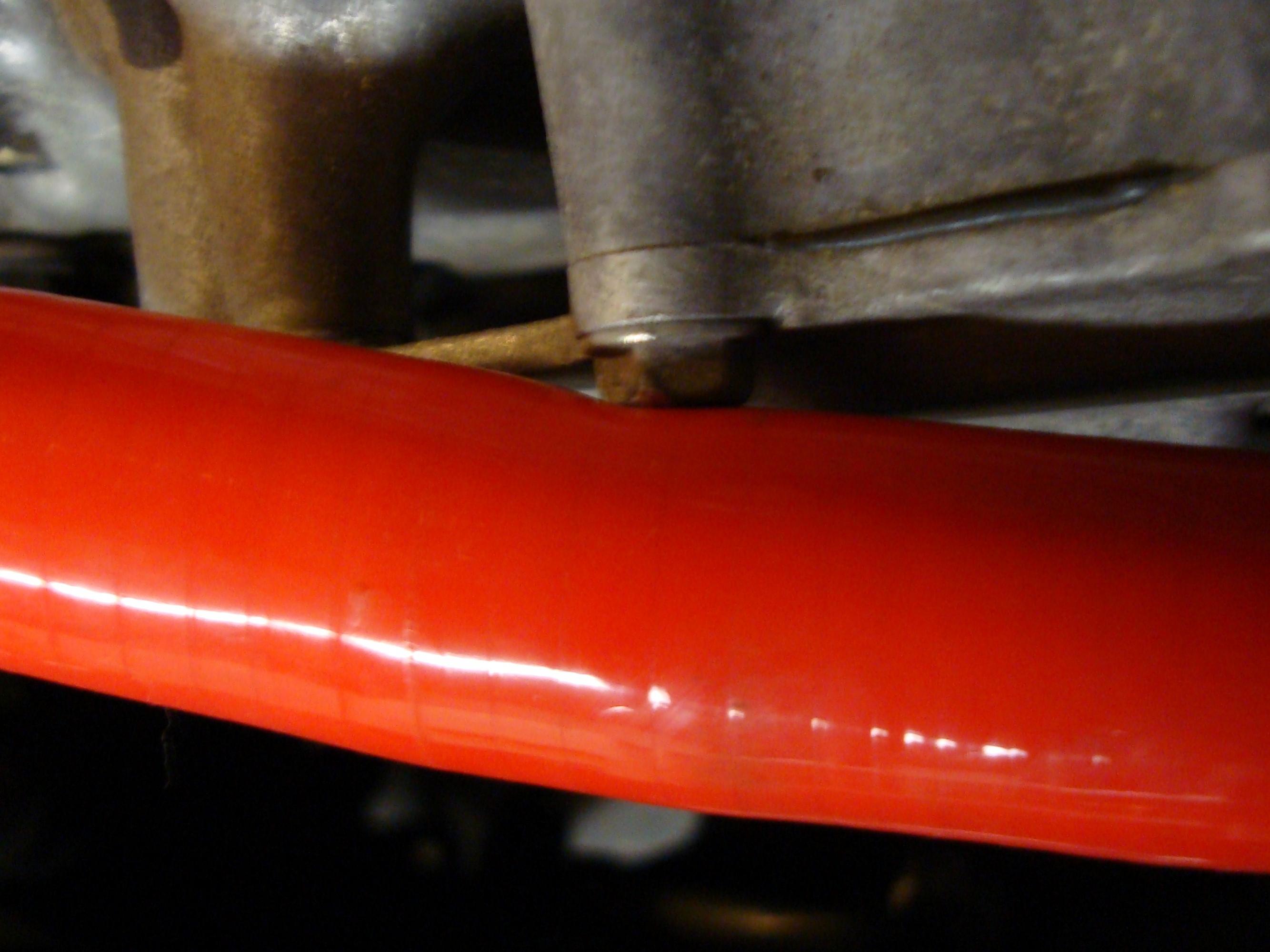

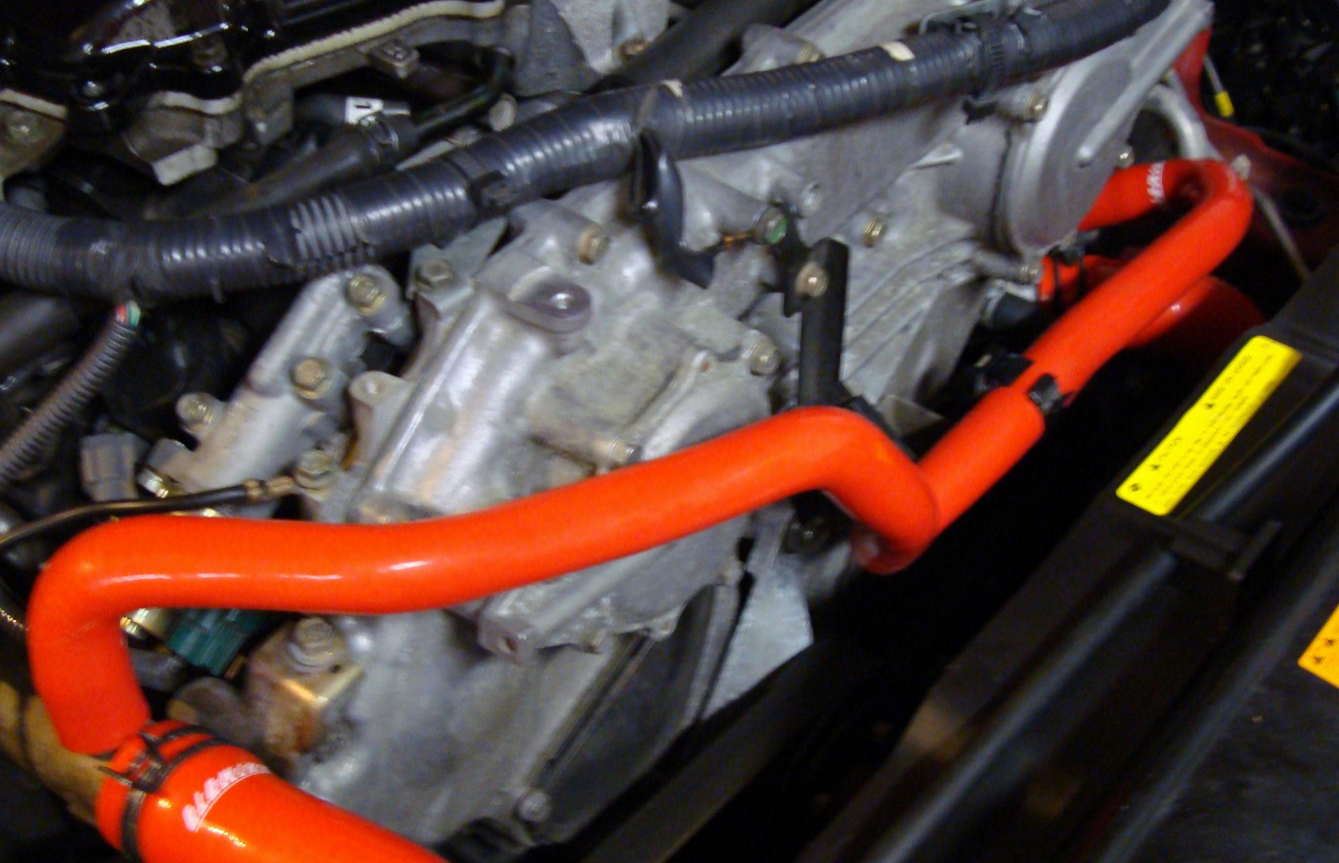

My oem doesn't rub even though it has the extra rubber covering on It. I think I got these pics to upload. I had to keep down sizing. Need less to say I got my money back on the extra ones I order in with no shipping cost to me to send them to me or back. I will give them that.

No I didn't put it on backward or sideways or upside down. I did try to stretch it to see if that was the problem and mess with the brackets but it still wants to push up against the bolt and cover. not good over time. It needs 1 inch on the bottom run and 2 on the top run with about 1/2-1 inch on the rise to make it fit like a glove. I'm gonna have to try the z1 or samco but they look like the same hose vender with different name tagged on them. I'd love to see pics of others on the car to see they don't rub. hate to take it to the track with the heat/vibration and constant rub. thanks guys.

The little hose will definitely not work with the revup....most of these hose kits were made for the 03-05 non revup engines....no one seems to have made an aftermarket hose set for the revup

If you want a full 4 piece set from Z1, ask for the Z32 coolant overflow hose to be added. Trim the J-hook portion and about 5 inches off of the other end and it fits perfectly on the Z33 (DE)
