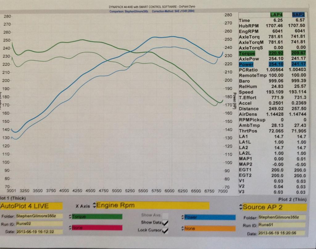

Mods:
Mrev2 and Spacer
Ultimate Racing HFC
MD XYZ pipe
Fujitsubo Catback
K&N drop in
Stock Run 240hp/235tq
UpRev Tune 251hp/250tq ***Sasha is still tweaking

Here's my final numbers... Car pulls harder, increased throttle response. I'm very happy with the tune.

Very nice, thanks for sharing! Increased throttle response is my number 1 priority, and I'm thinking even via e-tuning that should be easily achievable. Even better if I eventually end up with HFC's.
