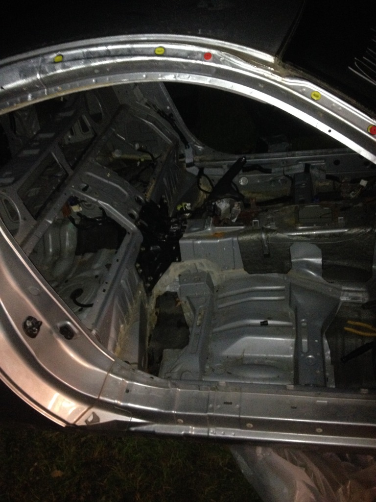

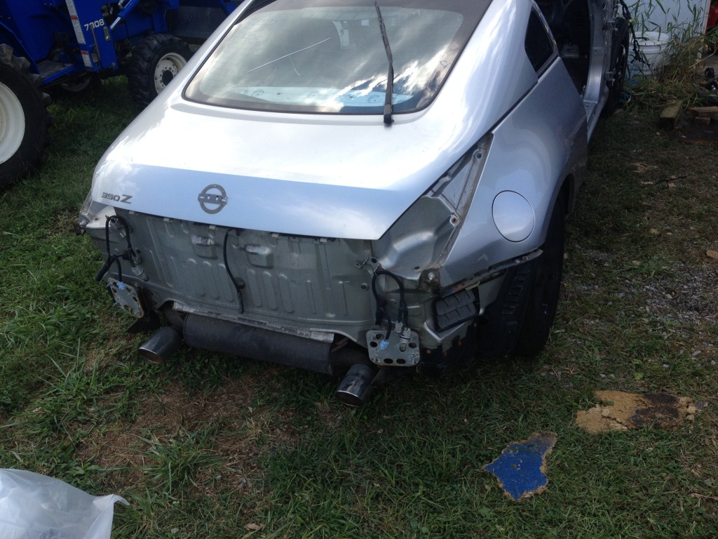

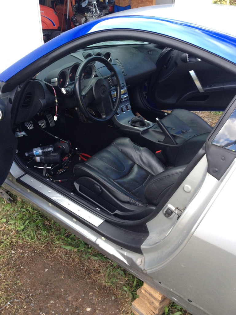

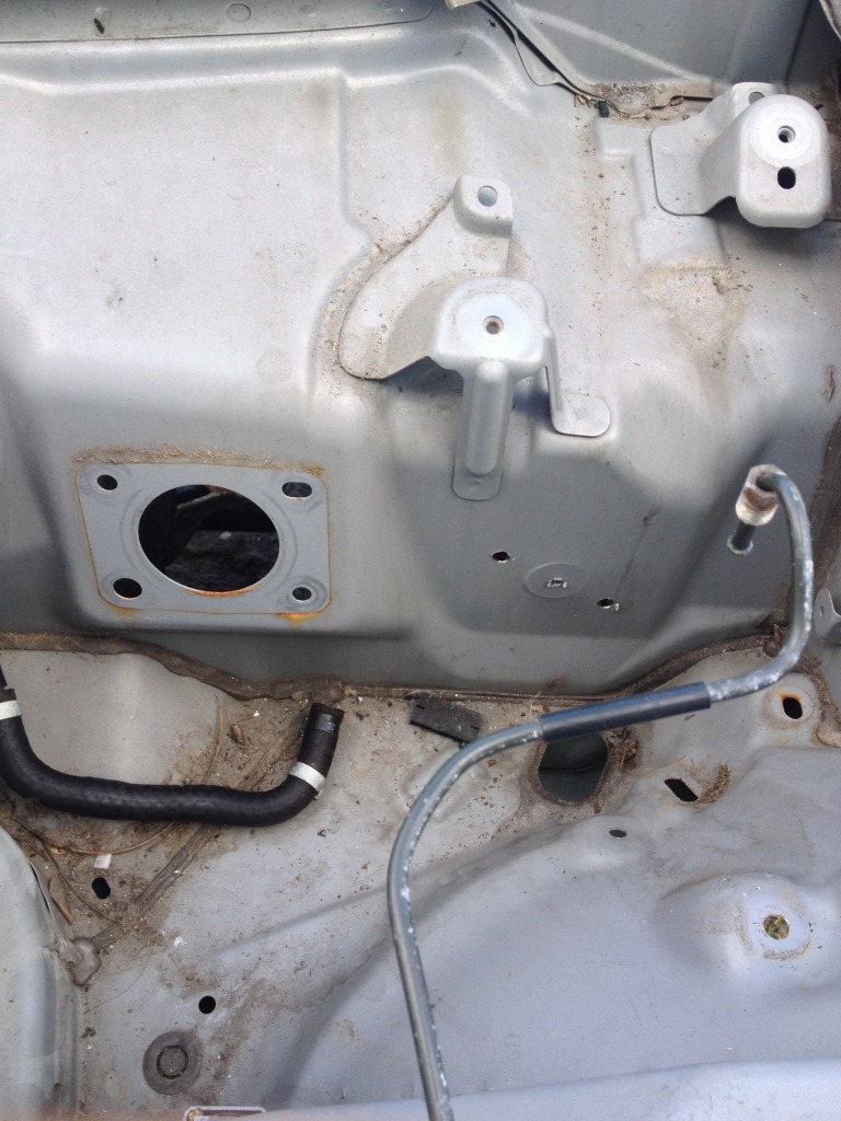

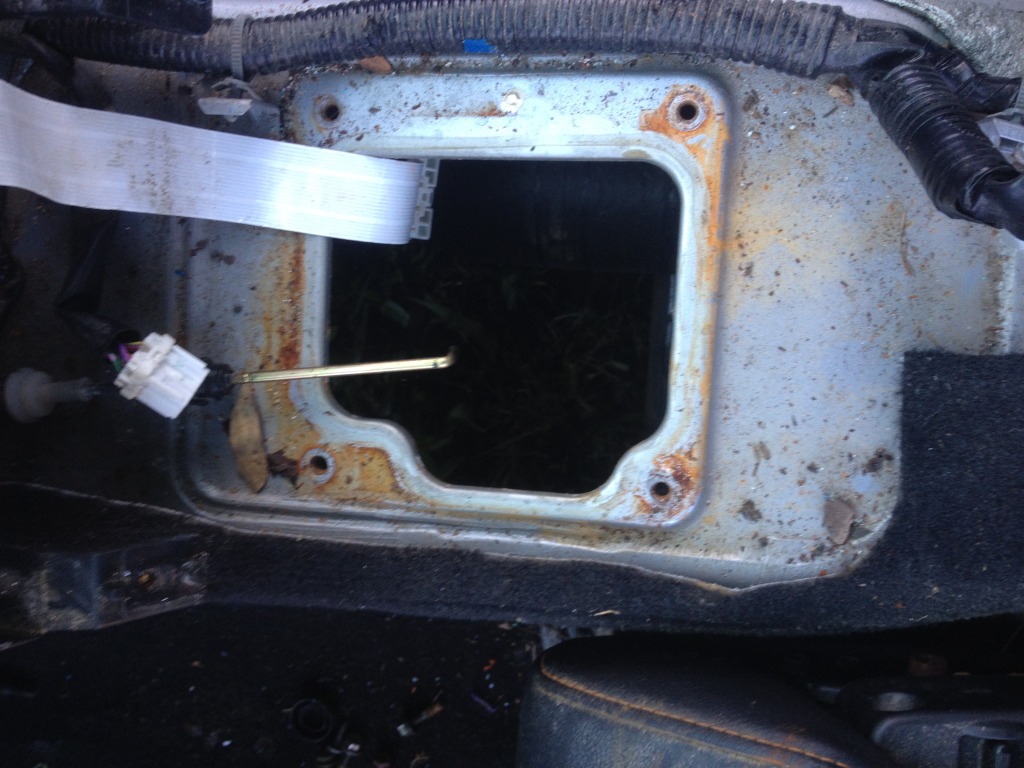

Day 9: and the problems begin.. Not sure if I've mentioned that the chassis I got is a 2003 enthusiast automatic. Mines a 2003 touring manual. I was told that the frames should be the exact same with all the holes drilled and such for both models.. This is untrue. Yesterday as soon as I got it home I noticed small things like it's got a different master solenoid for the brakes and it doesn't have a hole drilled for the hydrolic clutch fluid and line. But those are small things. One big thing I've noticed is the retainer for the shifter.. Where the hole is for the auto is a squar.. And the manual is a circle.. How am I supposed to bolt my shifter onto the frame? And the pictures just show that yesterday I began stripping all the interior and dash.

I don't envy the head aches that these subtle differences will cause you.
Sound's like you're going to need at least an angle grinder, dremmel tool and possibly some aluminum tapping drill bits.
Some more specific pictures of your problem areas will help folks give you solid advice.

I'd find a welder who can cut and weld that stuff to make it for your MT Z!
that would work to although all that aluminum welding could be even more frustrating than drilling and tapping...

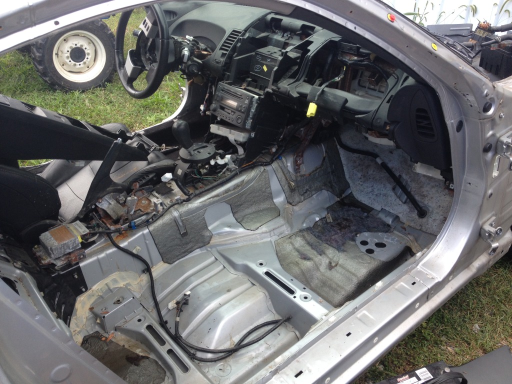

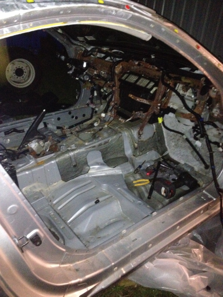

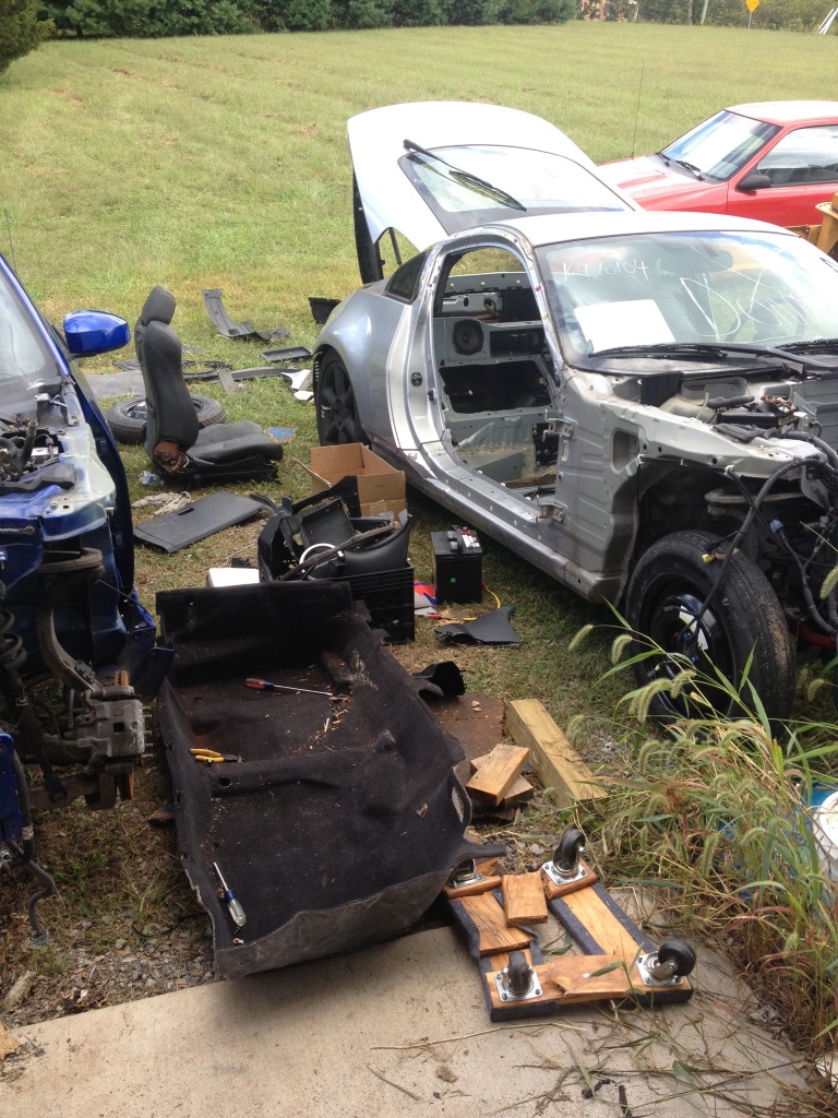

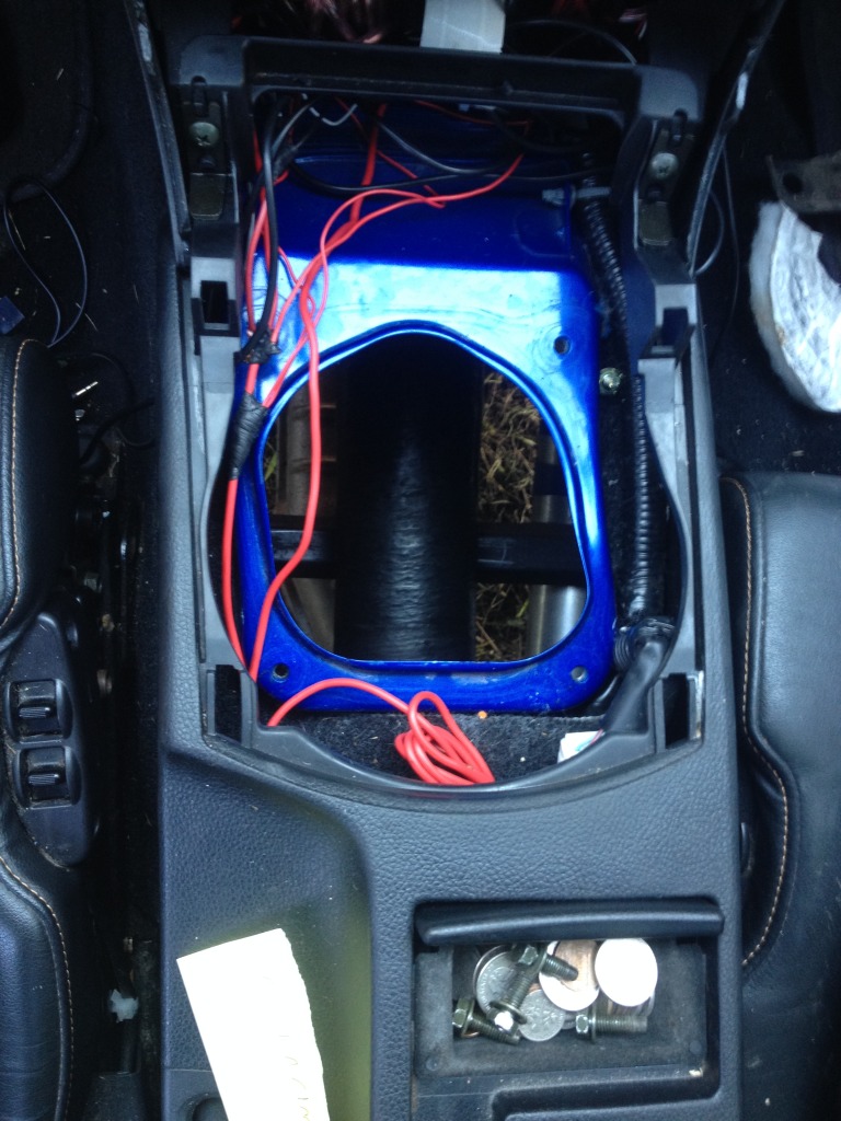

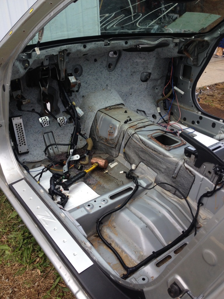

Day 10: finished gutting out my donor. And the shifter holes are the least of my worries, I'm just worried of what else is going to be different.. Mounting bracket for trans or anything big like that.. If anybody here has done a auto-manual swap please give me your input on what other issues I may have! Thanks
And it's so stripped down I might as well just put a LS motor back I'm it and make it my track car

Seems you got $1.15 in your tray there! Sweeeeet.

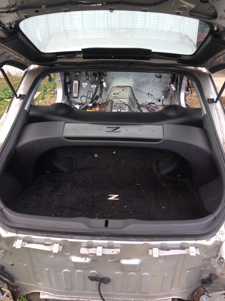

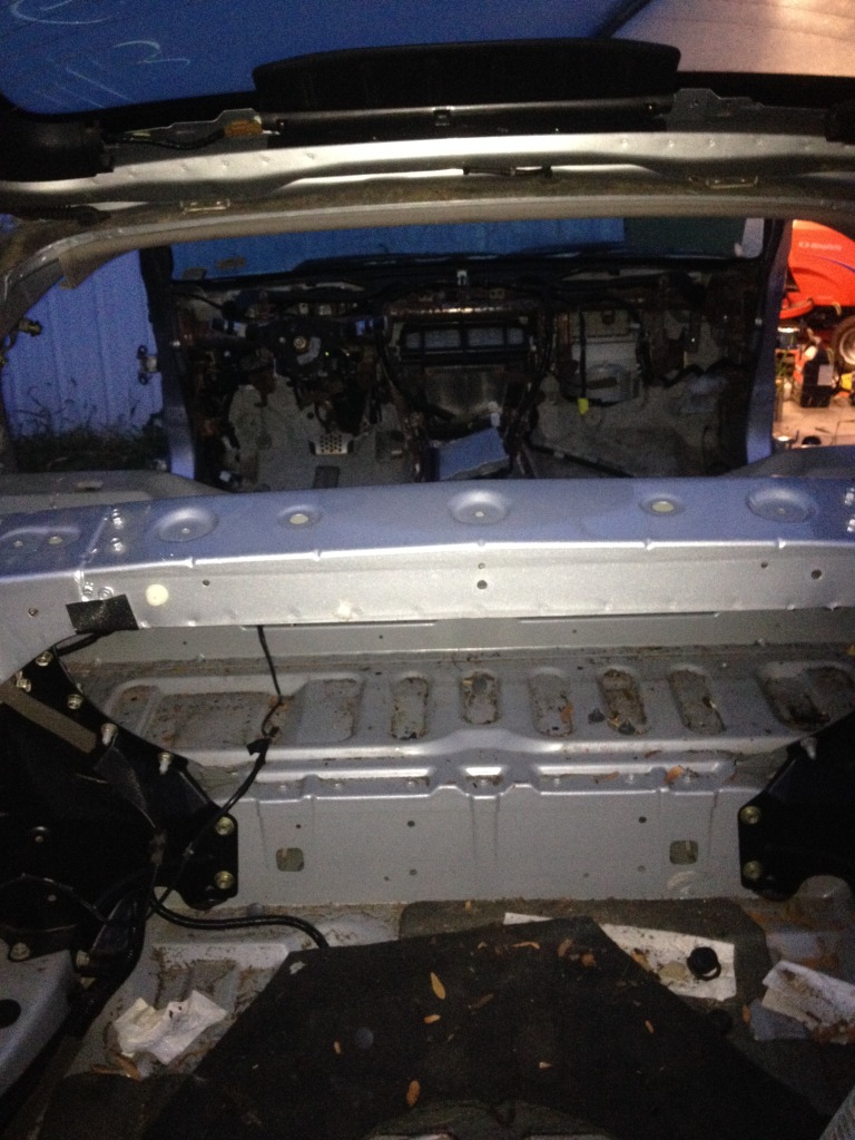

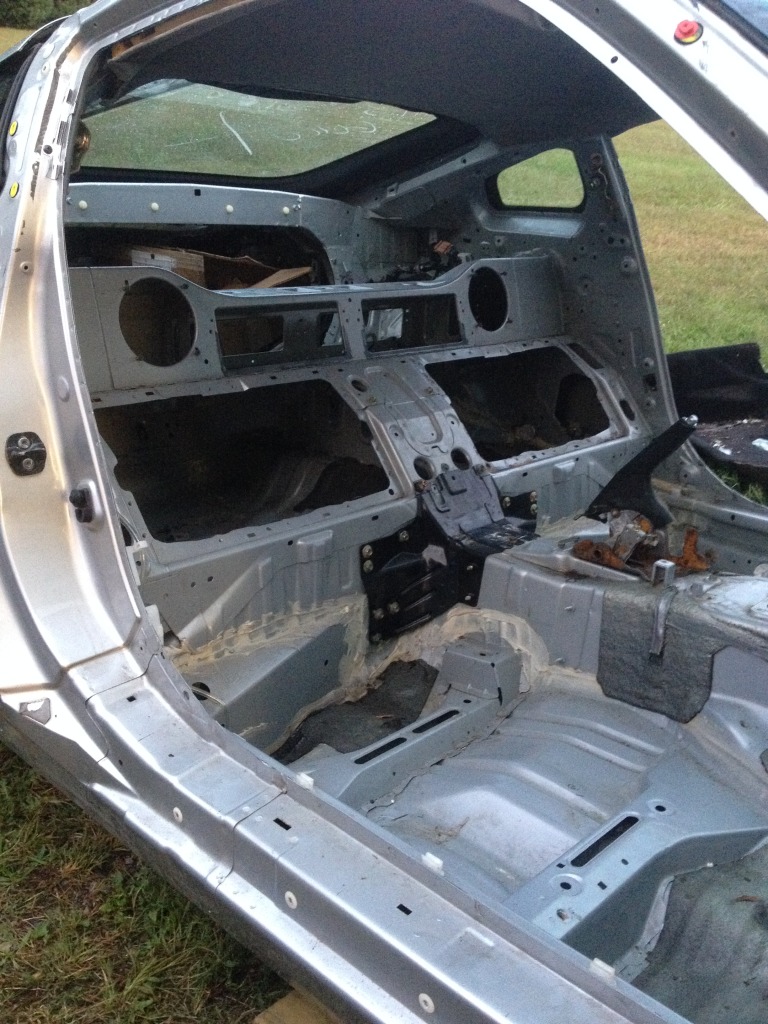

Day 11: about finished gutting the new shell out. Now I have to put everything back in..

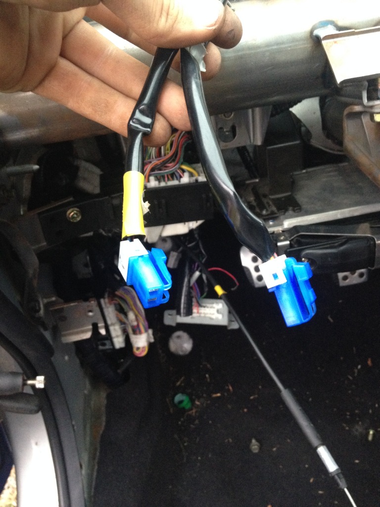

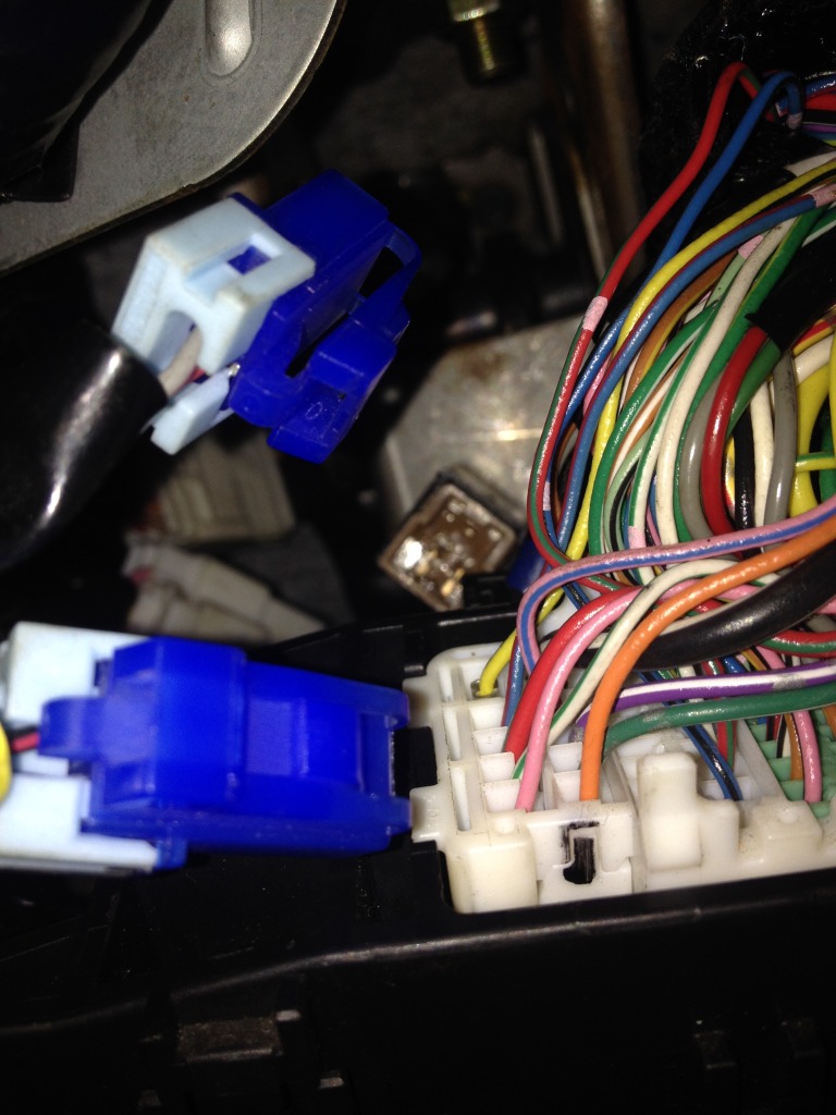

One problem I've ran in to is a plug on the main dash harness.. It figured out where all of it went except one plug.. There are two blue plugs on the same strand and they are the same exact thing, they are both together and I'm 90% sure one of them is supposed to go to the clutch pedal because that's what it reached and it's the only one not plugged up lol. But here's the issue.. There's two on the harness and only one on the pedal. I figured only one is needed so I plugged up the one with yellow tape on it. Think the other one is for different models?
