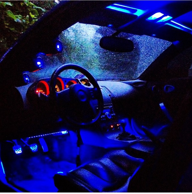

sorry ive been MIA for a while due to some broken bones.. finally back working on the project and im glad to say its almost done! ill post some pictures and answer any questions anybody might have.
Attached Thumbnails Totaled z rebuild : chassis and engine swap-img_4137.jpg   Totaled z rebuild : chassis and engine swap-img_3865.jpg

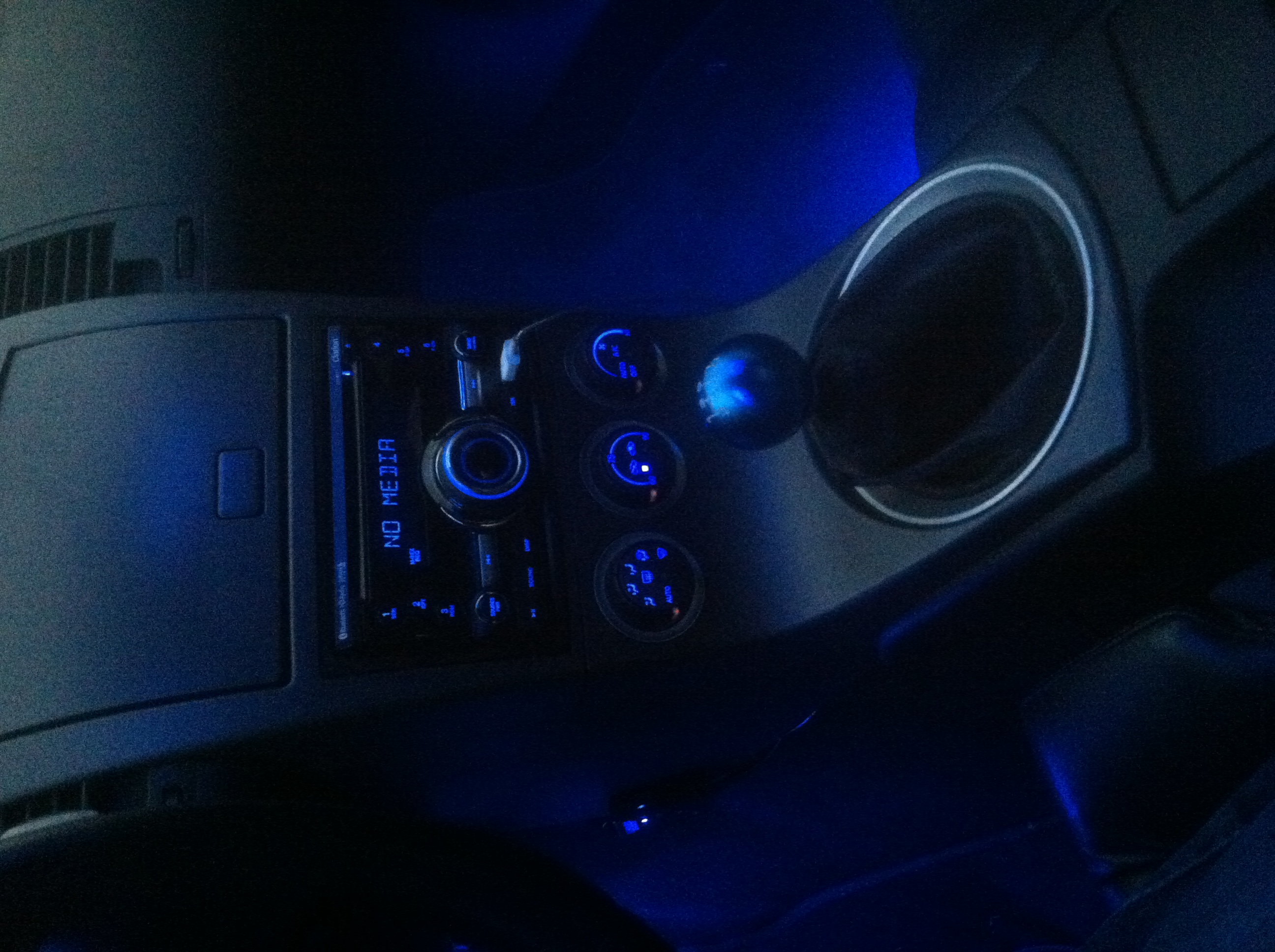

also decided to add a few unnecessary features in the process..
Attached Thumbnails Totaled z rebuild : chassis and engine swap-img_4184.jpg   Totaled z rebuild : chassis and engine swap-img_4240.jpg
