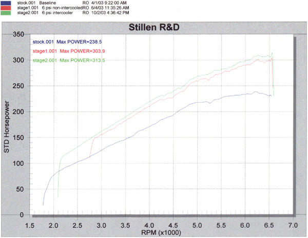

Default Dyno Sheets for STILLEN's Stage 2 Intercooled 50-State Legal Supercharger / C.A.R.B.
Originally posted by Philthy
Does anyone have a Dyno chart of the Stillen super charger with the stage 2 intercooler?
Here is the dyno sheet for the C.A.R.B. Trim, 50-State Legal Supercharger. Take the wheel HP at 313 and divide by .82 to get back to flywheel HP. I think you'll like the number.
For $89 you can jump to Stage 3 and push 405HP. This will invalidate the C.A.R.B. Cert. and void the warranty. But since you will only be using Stage-3 at the track (since it is non-C.A.R.B.) that's a non-issue. It's very easy to revert back to street legal/warrantied Stage-2. It only takes a few minutes to change out the pulley.
Here are the sheets:

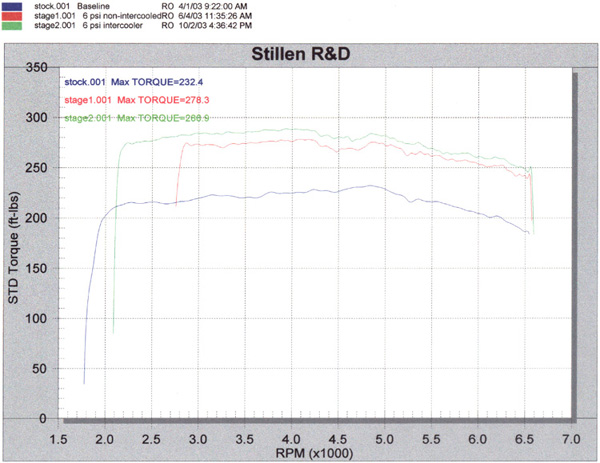

Default ....And here is the Torque Dyno Sheet
Here is the torque dyno chart. Please note that both the sheet above and this one also have the non-intercooled Stage-1 information as well.
AC
AC
