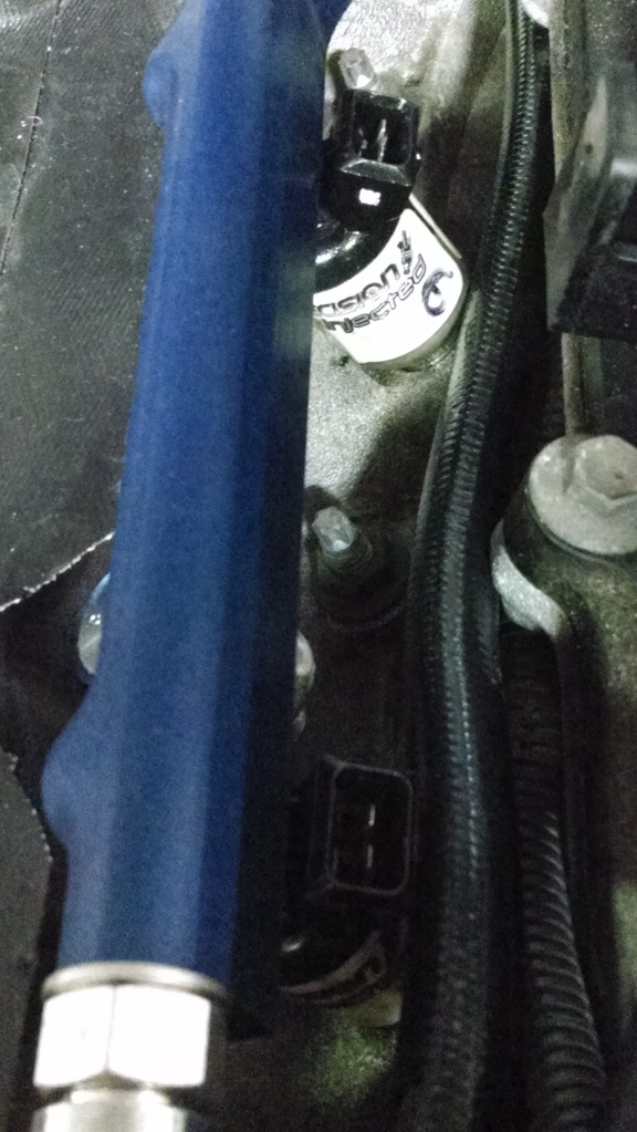

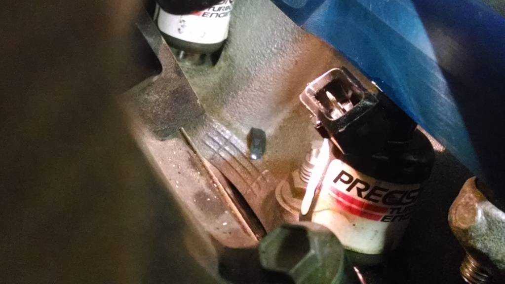

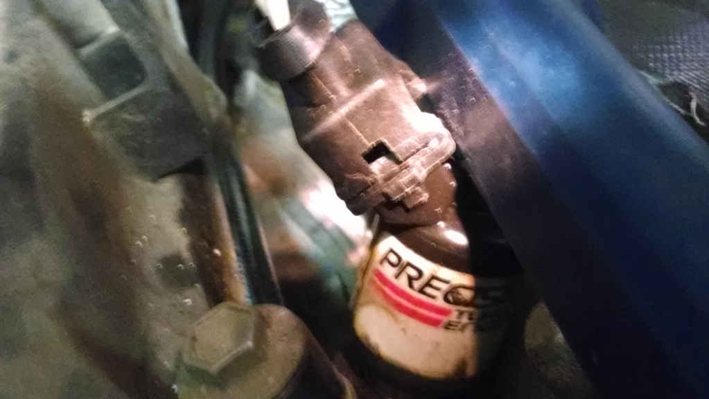

As requested!
Attached Thumbnails help with injector fitment!!!-img_20140203_103302041.jpg   help with injector fitment!!!-img_20140203_103341500.jpg   help with injector fitment!!!-img_20140203_103321851.jpg

^good stuff
Is that the same body as a RC brand injector?

From: NEW HAMPSHIRE
Charles says they are 62+ mm bodies bigger then the larger 60mm aftermarket injectors hence my problems with spacers.... so when I got home today I worked on the spacing and such, so I am using 15mm of spacers and ground the under side of the intake manifold... I also removed the lower intake to place on the bench to make sure the plenums sit flat and tight! I will update more tomorrow when my new gaskets show up!!!!

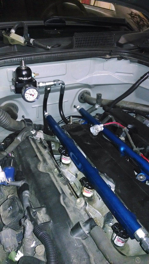

I meant to ask you....did you like your fuel gauge positioned like that? I turned mine more to the right because I read that stock pressure at idle should be around 51-52 psi......with the gauge perfectly upright the air bubble made it really hard to see to set? How does it work for you?

I don't love or hate that spot. With the cosworth I can look right down an alley and see the pressure.
are you saying you tilted the entire regulator or just the gauge some? my ocd wouldn't allow the entire regulator to tilt.
only the gauge, turning the regulator would drive my f-ing nuts!!!! Lol you can see in the pic I just tightened the gauge a quarter turn more so 50-60 psi range is easy to see!
