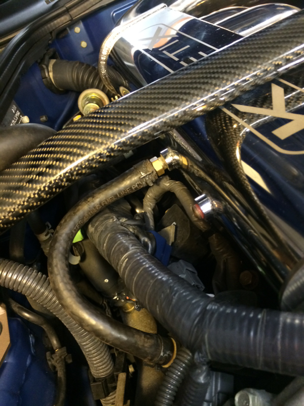

These are the two on the passenger side and then the one from the EVAP goes to the back one but I can't get a pic
Then these are the two I coupler together correct?

The last pic looks like the throttle body coolant lines that would have been connected to the original plenum.

It's hard for me to tell completely on mobile but as the person above me said, make sure those lines are still on your TB also it looks like your strut may not have enough clearance so double check it cause it will make it seem like its running rough. Again though its hard to see it on mobile.

Those lines don't actually connect to the TB. They connect to the original upper plenum that OP took off. If OP bought new, the kit would have included the brass piece to connect the hoses to flow as one.
So they don't connect to TB? I just had an adapter in my garage and connected them together. Didn't come with anything to connect them

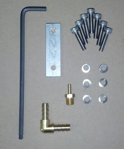

The right angle brass piece in the bottom left hand corner is what you are missing. The seller probably forgot about it, and didn't supply it when he sold it to you.
Old Aug 15, 2014 | 09:59 PM
sfhshockey77's Avatar
sfhshockey77
Joined: Jan 2014
Posts: 204
From: Buffalo, NY
What's the other gold piece?

Also do I need a right angled connector or will my straight one do just fine?
Old Aug 15, 2014 | 10:07 PM
waldo36's Avatar
waldo36
Joined: Sep 2011
Posts: 309
From: Murfreesboro, TN
The other brass piece is for I think FI guys when they need another gauge. They install that piece and connect a 3rd hose. And ya, a straight piece is fine. Just so long as everything fits together.
