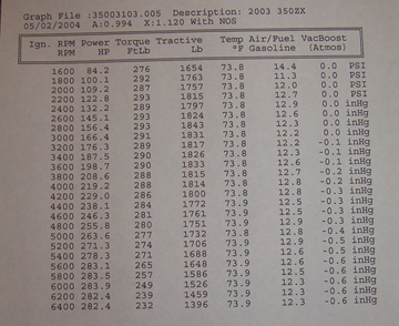

well I just had my dyno done by Comptech out in EDH, California and I was pleased with the results..............A/F readings are ideal and good results both N/A and with 55 shot of NOS.............

With 55 ZEX Jets in Snoz Nozzle!.......Next time I will dyno with my 75 jets...........

N/A........No NOS

Are those A/F ratios good? I was told yes by Comptech

I think nearly 13.0 A/F @5200 RPM under nitrous is a bit on the high side. I think with a 75 shot your A/F ratios are going to be even that much leaner--too lean for comfort if you ask me, especially if you don't have any timing retard. Have you considered an ECU reprogram at Technosquare?
