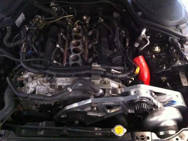

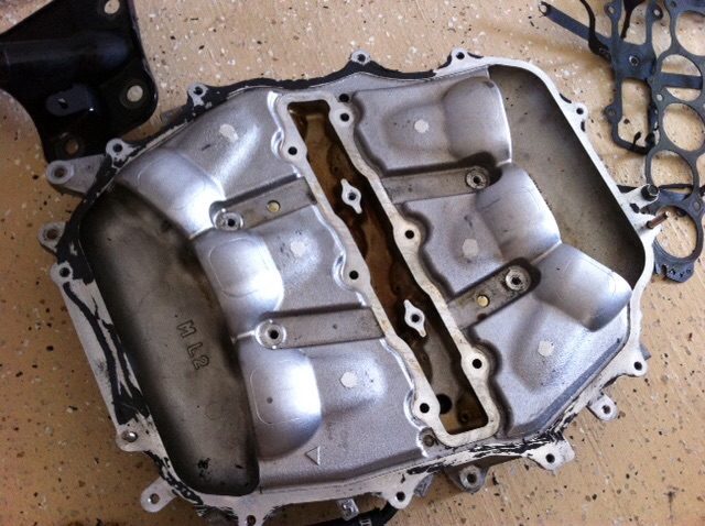

Hi guys,
So I was working on my procharger on my Z. Took off my Kinetex plenum (which I don't recommend getting, mine was warped and has a huge air leak causing a bad idle). I was putting the stock one back on when I notice oil in the plenum. Plus in the past it seemed like I was burning oil cause I had to put oil in every 2 months.
Will a catch can resolve the problem? Which one could I use with the supercharger cause I can't mount it in the front of the car

It's normal for oil to be there, just get any catch can, maybe one with a baffle.

Yes DarkZ03 is correct I had oil in mine when I installed my MREV 2 i burn a bit but I have a rev up I had a catch can on my cobalt ss turbo but didn't catch anything but it never burned oil either. Good luck

just dont pull air from the valve covers to the intake.
problem solved.
