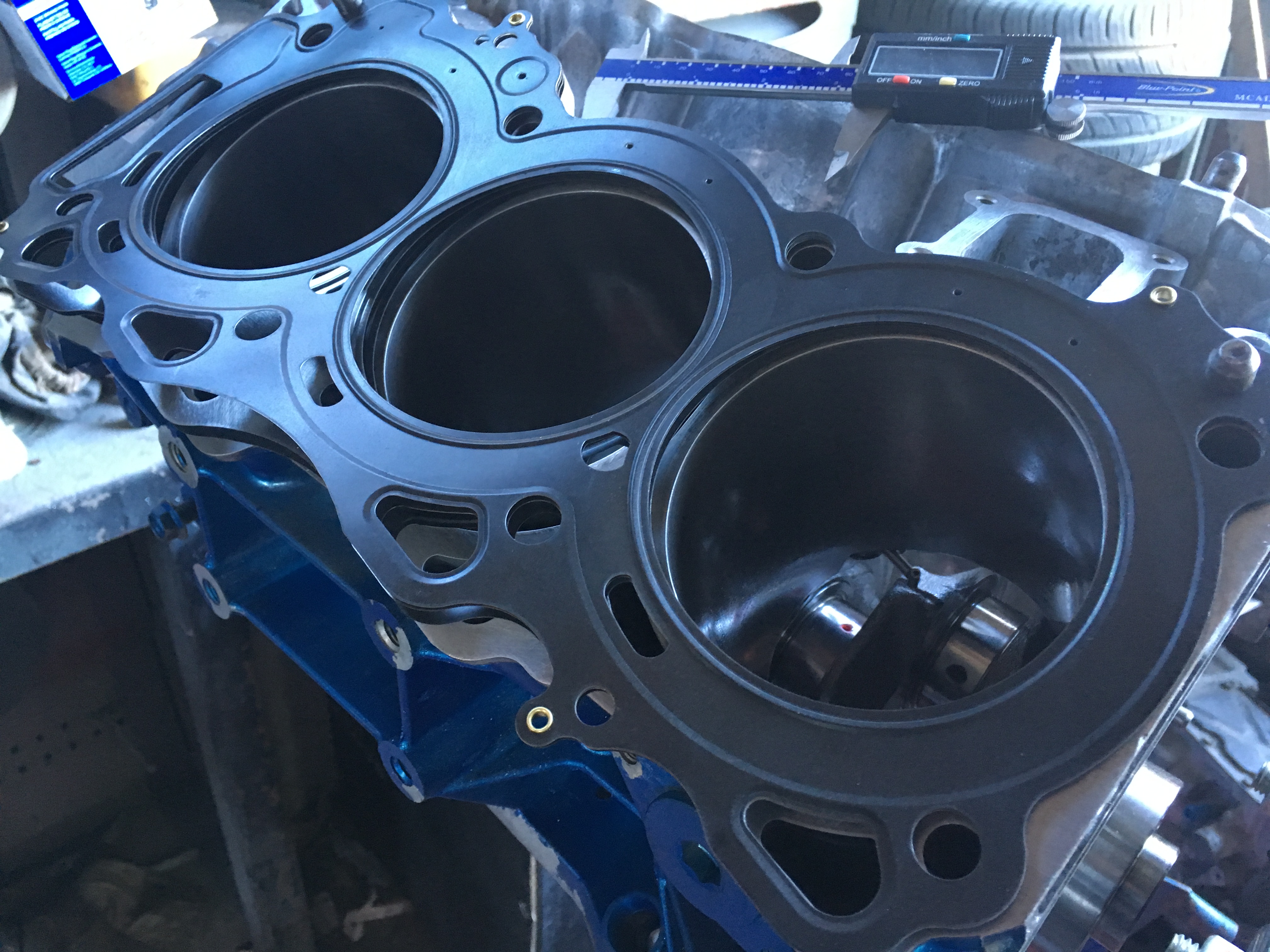

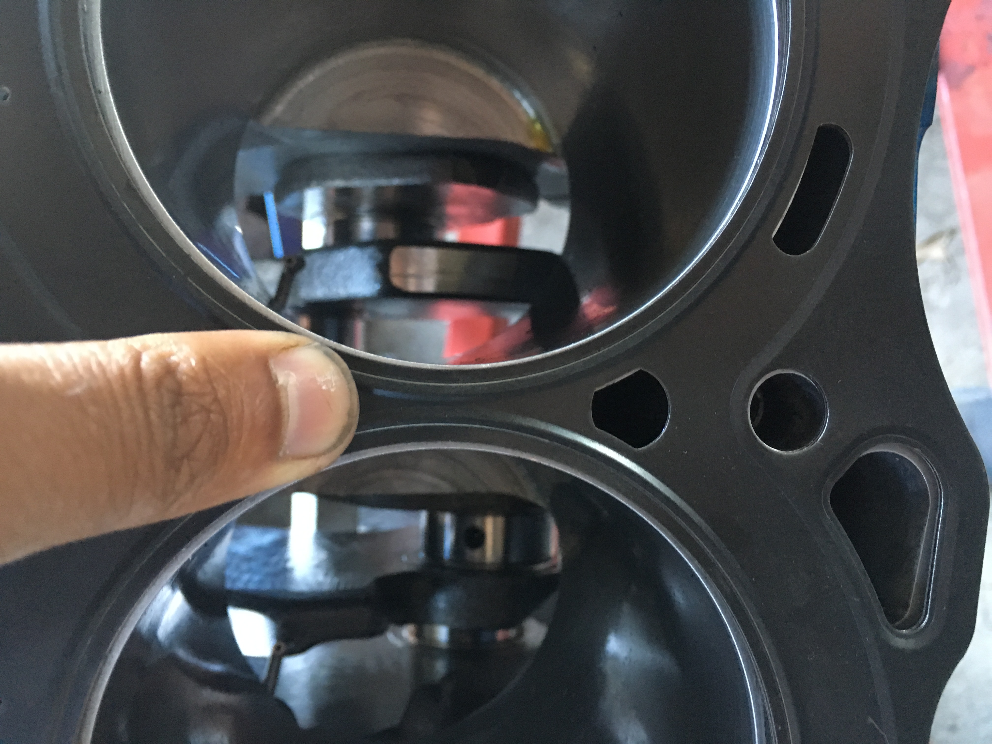

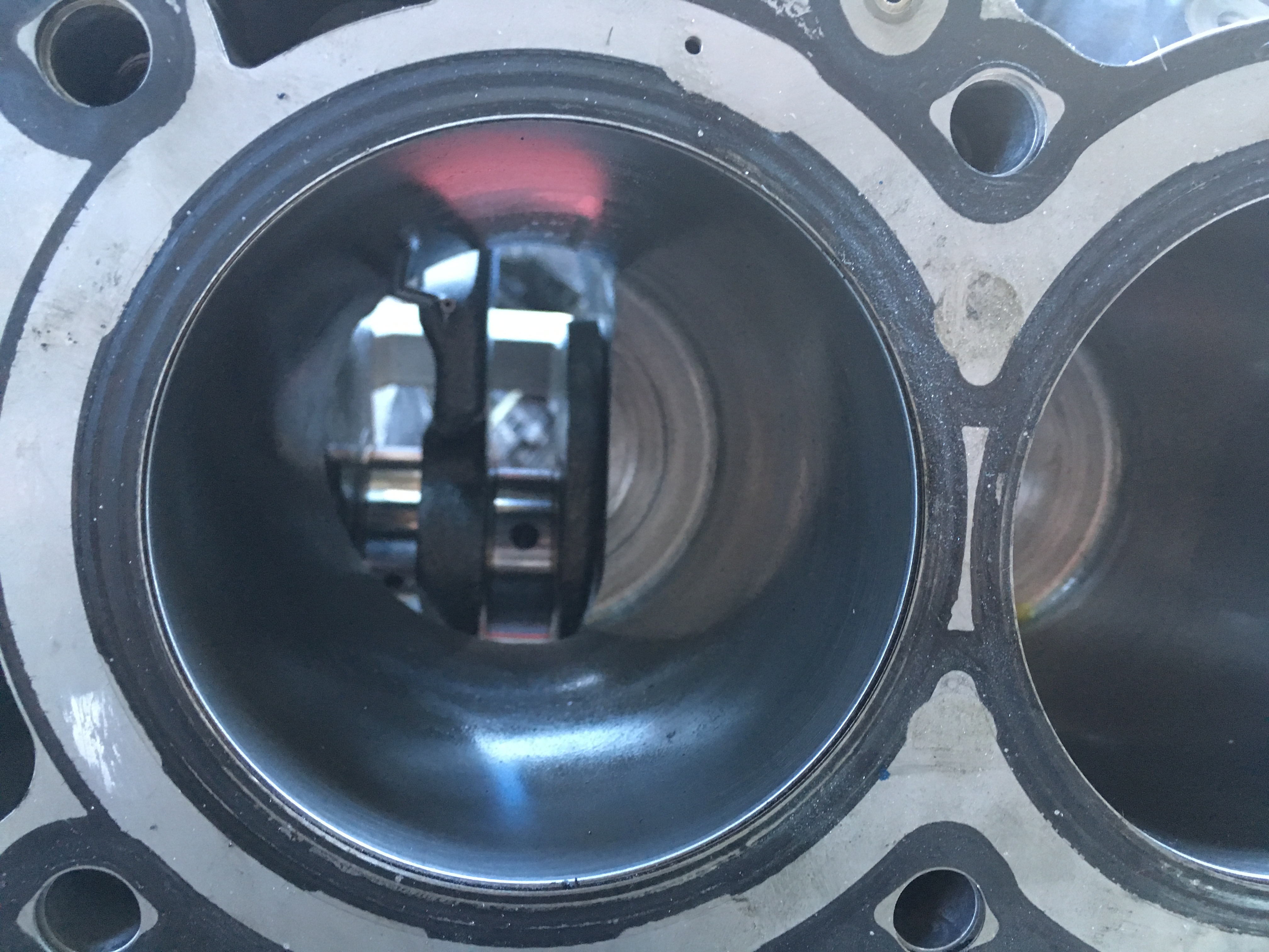

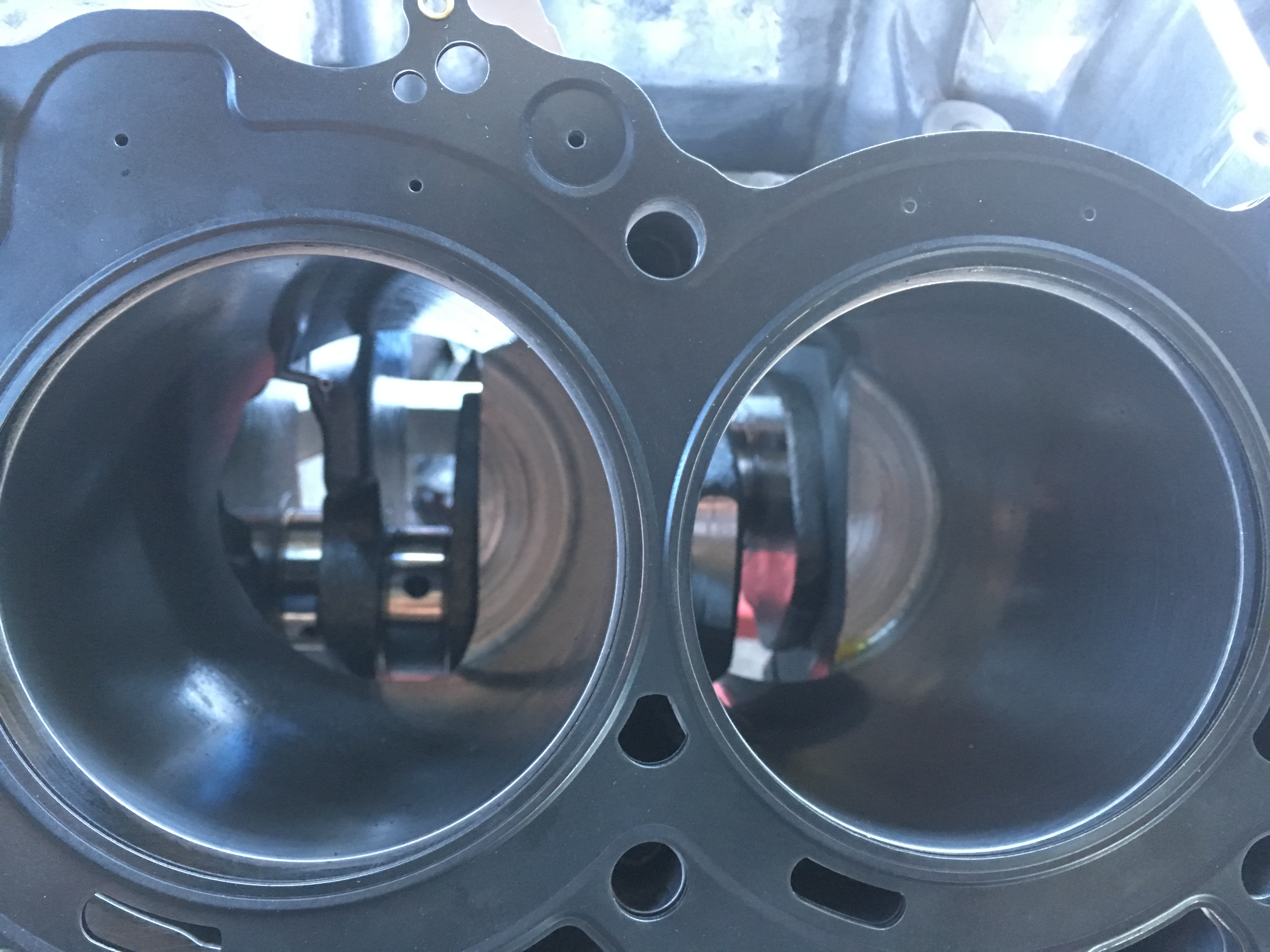

So installing this Cometic Gasket 96mm, my block is bored .20 over however it still seems to fit quite larger in comparison to the OE gasket and the old MLS gasket that came out. I assume it will crush a bit but how does this look to anyone who has dealt with these? I am also boosted. Thanks in advance

Cometic also make a 100mm & 101mm gasket for the VQ motor. Check the part# on your gasket. This looks like it maybe a 100mm gasket

I actually measured the gasket with a micrometer and it is the "96"mm gasket I think it's like .5mm over my block measured 95.6mm from the factory 95 but the gasket seems huge and I bought it before I was even going to bite the block. So this definitely looks too big to you guys? I have a feeling the gasket will crush and become a little bigger... But I can't imagine it on the block pre-bored it would have been even bigger...
