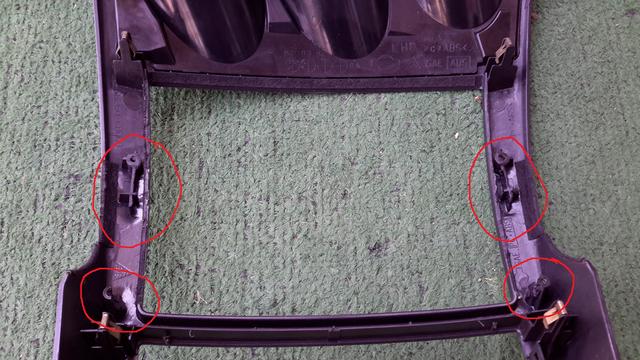

The back of the dash console needs to be modified in order for a tablet to fit. A dremel is required to cut away certain parts of the dash. Note: If you ever want to return to stock, the cubby will have nothing to screw onto since you have dremmelled that part off, but the cubby will still sit in there fairly flush without being screwed to anything.
1. Remove center console and cubby assembly from the dash.
2. Unscrew cubby assembly from dash leaving only the console and the gauges.
3. Use dremel to cut away plastic on back of console. See pic.
4. Test fit the tablet and use dremel to clean up any imperfections.
[Link to larger pic]
Note: The two plastic pieces circled on the bottom of the picture can be cut more or less depending on how big the tablet is. Always take measurements. I cut mine in about half.
